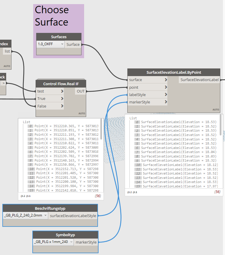

I’m trying to automaticaly create SurfaceElevationPoints at the marked spots:
For the spots i have a list with points.
But before i create newLabels i want to check if there already labels exist.
My Question:
Is it possible to find the existing labels and get their coordinates so i can compare them with the list before?
Assuming the labels are on the same layer:
  1. Get all objects on layer
  2. Convert to Camber Object node
:man_facepalming: so simple :sweat_smile:
Finding the objects with the layer was my idea too… it is working.
But i didn’t try to convert them. It’s works perfectly :smiley:
