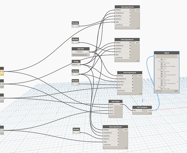

I start my adventure with dynamo and I I want to do a script that will export circuits to excel.
I have a problem with filtering the list by the name of the switchgear. How can I do this?
You could use group by key, but it’s hard to say without seeing your entire graph :slight_smile:
My entire graph :slight_smile:

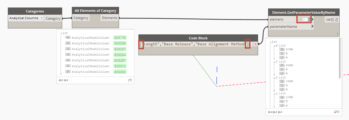

Okay, a few things you could do:
  1. Use Element.GetParameterValueByName instead of “Parameter.ParameterByName” and “Parameter.Value”
  2. Do not use several “Data.ExportExcel” nodes, use a single node and organize your data before feeding it to the export node…
  3. Use List.GroupByKey to organize your lists/values using your name of the switchgear as keys… The node works like so:
  4. If you on the other hand wish to filter out certain values and only get some of the names to pass through you can use a List.FilterByBoolMask that works like so:
  5. If you wish to simplify even further you can get all your parametervalues using a single node instead of several :slight_smile:
Keep in mind I’m using “List level” (the little @1) which is achieved by clicking the rightfacing arrow on the node) and that you’re using Dynamo 2.0 which will mean that my “{” will be “[” in your version of Dynamo :slight_smile:
