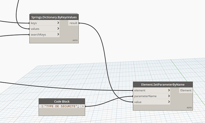

It worked! thank you very much bvs1982
I used this node from Springs
