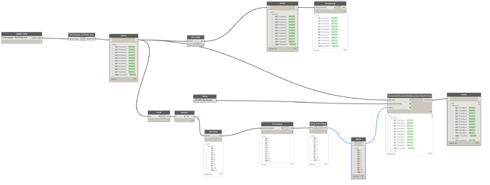

Dear Azubike, here is a snapshot from the script, but as you can see the highlighted part it is reading null!
Next time come back early if anyone ask you to provide images who is trying to help. Follow the guidelines How to get help on the Dynamo forums
I don’t see why you need the list.create node coming from the AllElementOfCategories node. I think it is throwing your list structure off in the set parameter node.
i needed to make them two lists so that each item from the list would read from the equivalent list
I have made some modifications to the script but now all of the values for the elements have the same value!!!

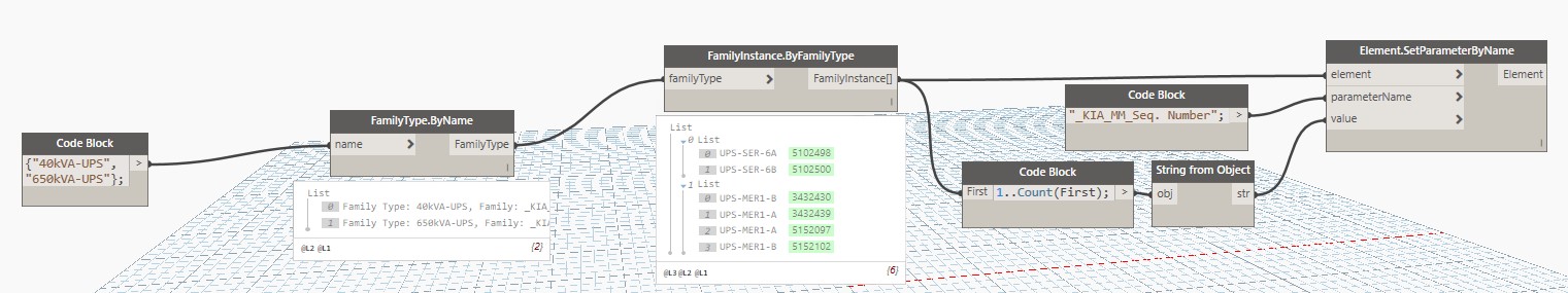

Dear Erfajo,
Thanks, your script seems much easier
The only problem is that i am trying to give a sequence number to each element of the family type.
I tried using your script and modifying the first part to read all of the family types like this:

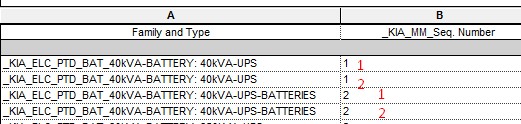

but now in revit, each family type is reading the same sequence number like this:
I have mentioned in red how i want the result
How can i solve this?

Sequence parameter Trials.dyn (19.6 KB)
This is my script, i have placed the “GroupByKey” but i couldn’t know which node to use for the “Element.ElementName”
