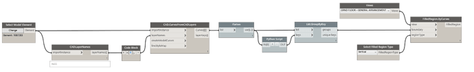

Filled Region By Curves Error
Just luckily solved it myself :slight_smile: if anyone has the same issue here’s my solution
Python
