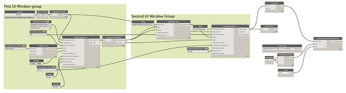

I extracted the relevant nodes from my network to test this and it works (posted image).
But when I return to my full node network and insert & connect a List.FirstItem or List.Flatten node, the familyType warning returns.
I am now researching list lacing and list levels.
Your image is illegible. Make sure the node names are visible before taking a screenshot and be sure to pin all your node preview bubbles.
Check the list structure of the output list first and then determine what’s necessary to reduce to a single item. You may need a Flatten and a FirstItem since Flatten still returns a list. You could also just use @L1 list level to force each family type in the list to be placed.
Ooops! Sorry about that.
Trying out your solution.
Thank you, Nick_Boyts!
Flatten did the trick. I turns out I that the user input for level in the full node network was the culprit. Resolving that is for another topic.
