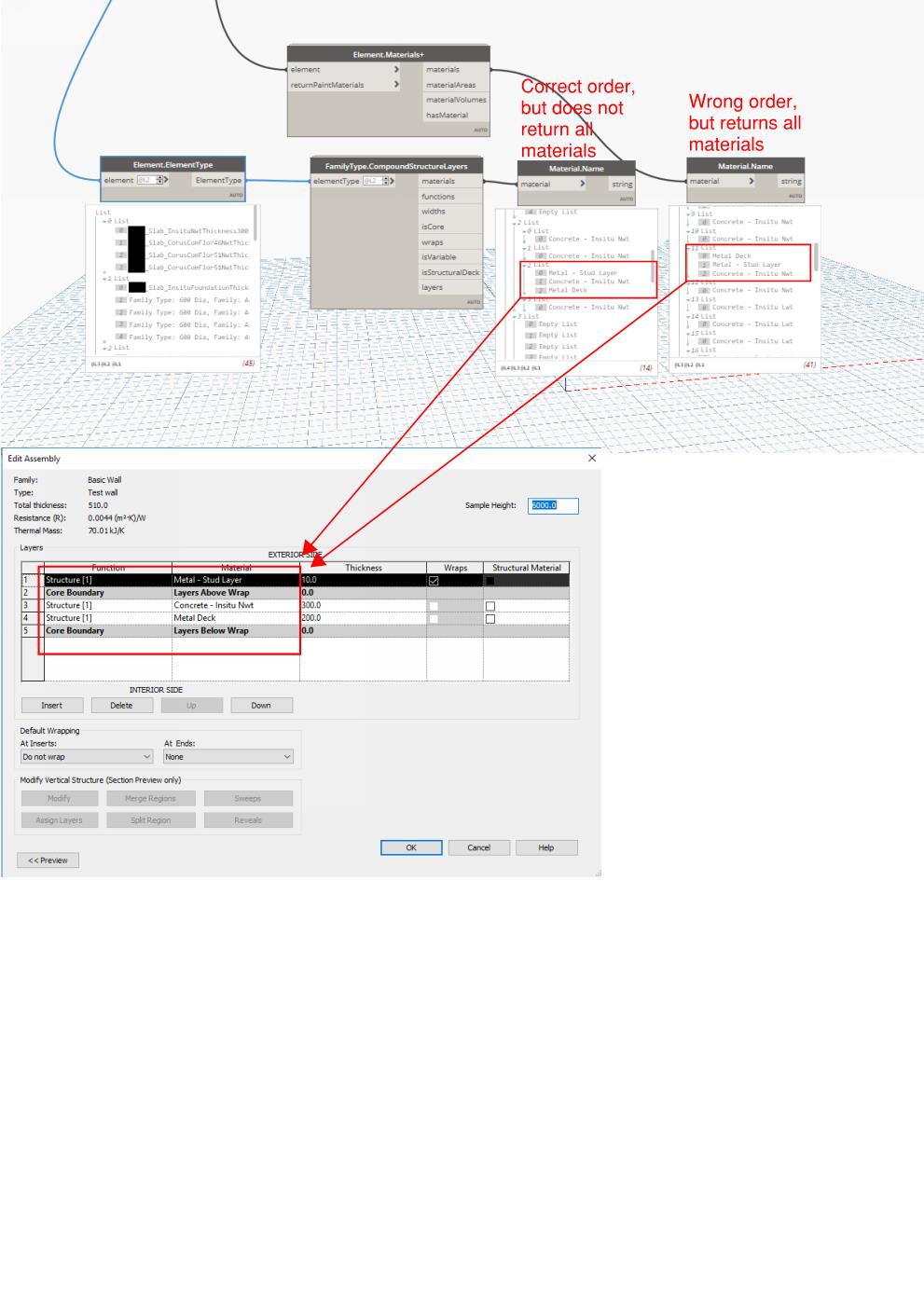

I am a bit stuck here. I have tried to get the material make up of a family type, but both nodes do the one thing that the other can not
The Element.Materials+ nodes from clockwork gives me all the materials of the elements input, but in the wrong order
The FamilyType.CompoundStructureLayers node from Clockwork does not give me all the materials, but so far it seems to give it in the correct order for the materials it can find from the family type
How could I get the material makeup of an element or family type in the correct order as at the moment it doesn’t seem the work?
