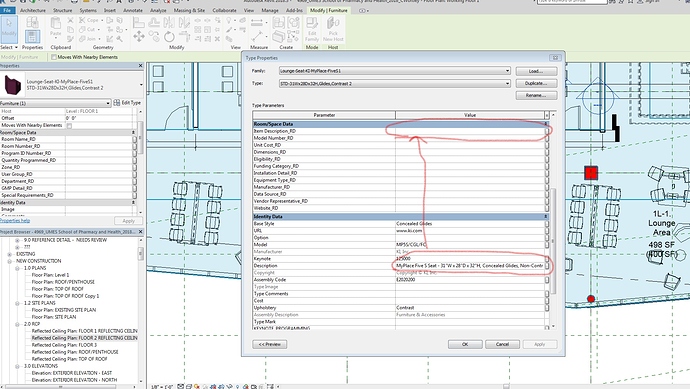

I am currently working on a script for a co-worker that will take the manufacturer values from a family and input those values into the shared parameters for that same family. Right now I am able to pull the values from a family but am unsure how to input those values into the families shared parameter (See screen shot). I was wondering if this had been done before and if so what a good way to go about doing this would be with dynamo.

Hi Alban,
In the first photo I attached there are parameter values included for each family we received from our manufacturer. We received a shared parameter file .txt from our client that we need to input alot of the same information that came with the manufacturer families. If we had to input this all by hand it would take hours so I am working on a way to take those manufacturer values (identity data), url, description, model number, etc. and input them into the appropriate place under the shared parameters (room/space data).
