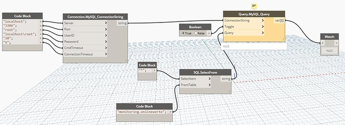

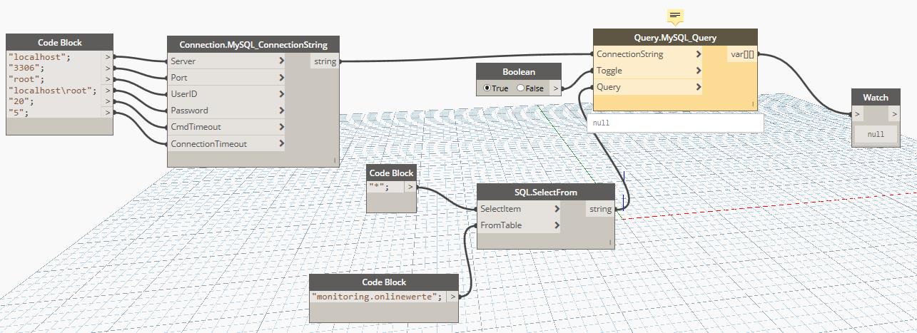

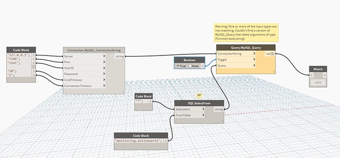

i am trying to connect Dynamo to an MySQL Database running on XAMPP (local) in order to import data into Revit,
The problem I’m having, is that I can’t seem to manage to connect to the database because Dynamo keeps telling me “Dereferencing a non-pointer”.
The code block at the bottom of your graph doesn’t define a table (the requested input), but attempts to call a function of a class which isn’t defined.

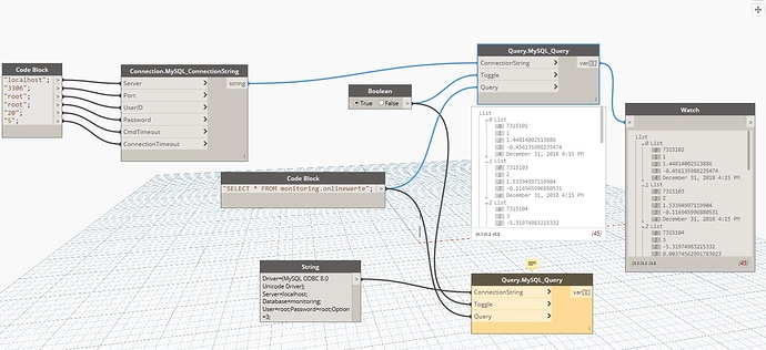

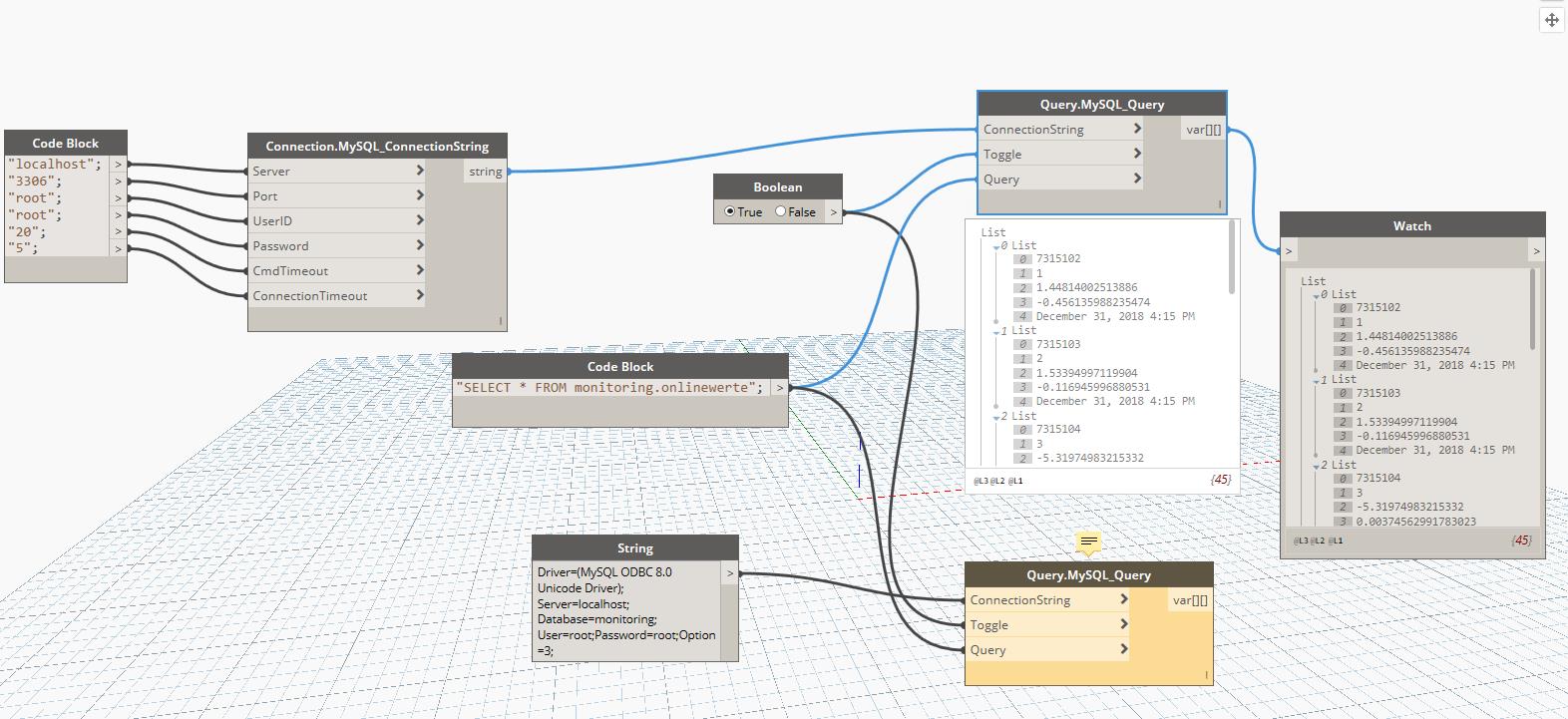

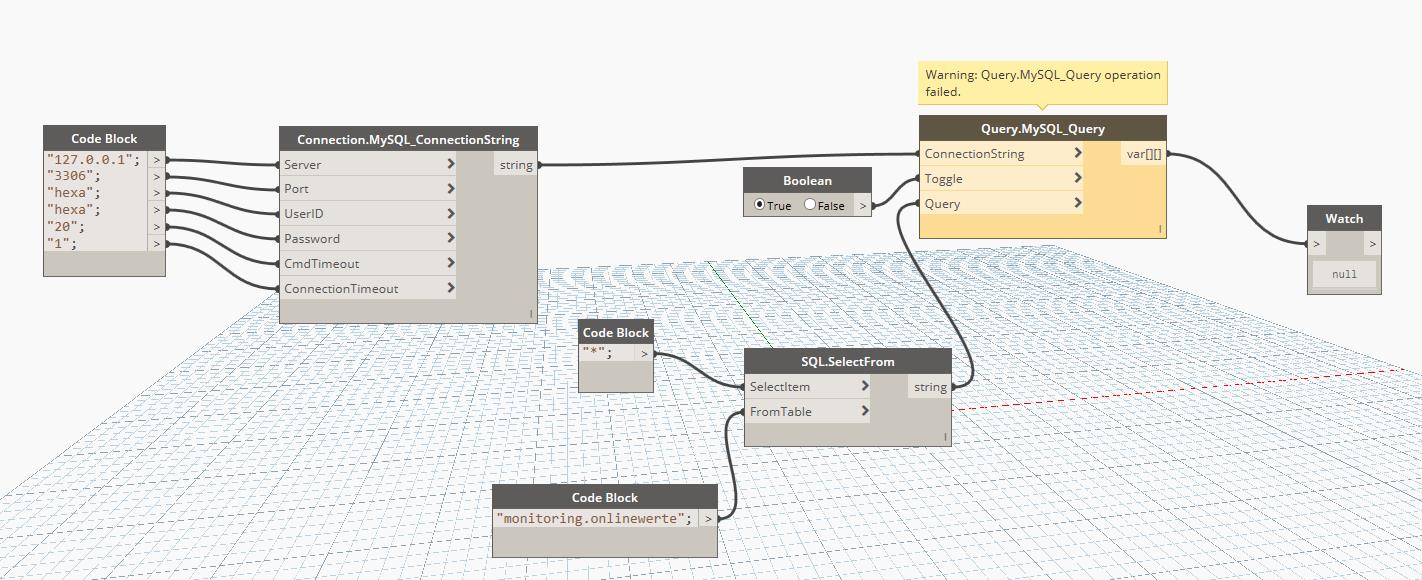

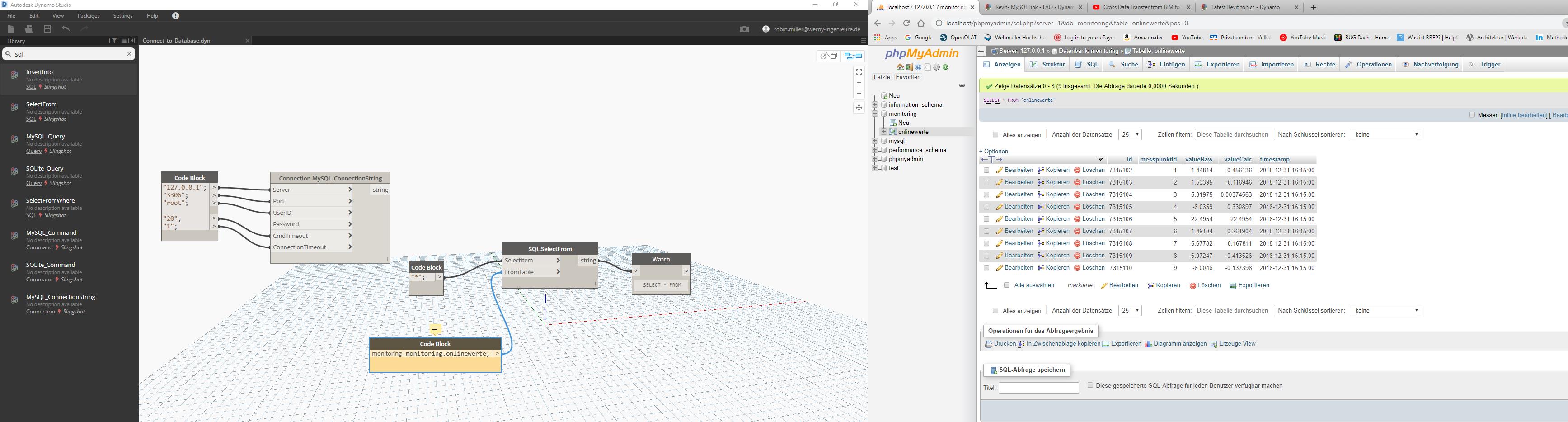

Alright, thanks guys. Managed to connect to the database. but get stuck right after. Sorry, total Dynamo noob here.
Any advice on how to solve this? Not sure how to change boolean and string values in Dynamo!?

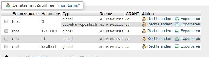

User ‘root’ doesnt use a password (this is a local server running under XAMPP)
i also tried adding a user “hexa” using the pw “hexa” but that doesnt make a difference
It is sophisticated- but the permissions/authentication can be complicated

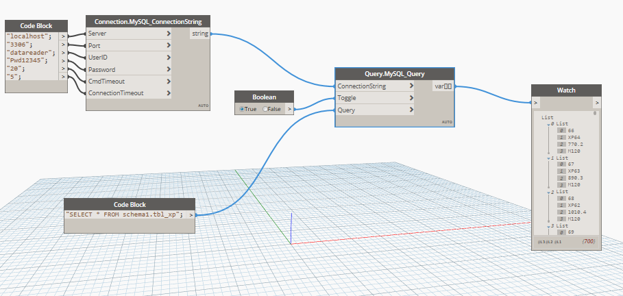

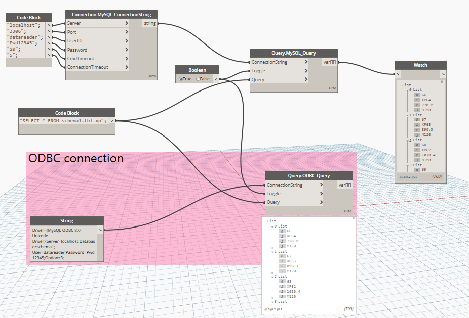

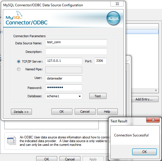

You might have installed it so that it requires SHA256 authentication ie needs a TLS connection or RSA key pair. You also need to set permissions on the database (schema)- refer below screenshot
