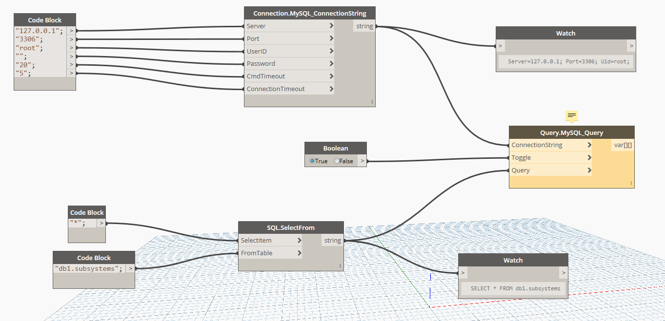

here is the dynamo scheme :
On Mysql side, the configured port is 3306
i use for the moment the default root user (no password). (I also tried with another account w password).
So if You have an idea I would appreciate.

Well I have final use a walkaround.
As I saw you guys using workbench I installed it and now it work perfectly.
Don’t know what is wrong with my easyphp mysql server …
