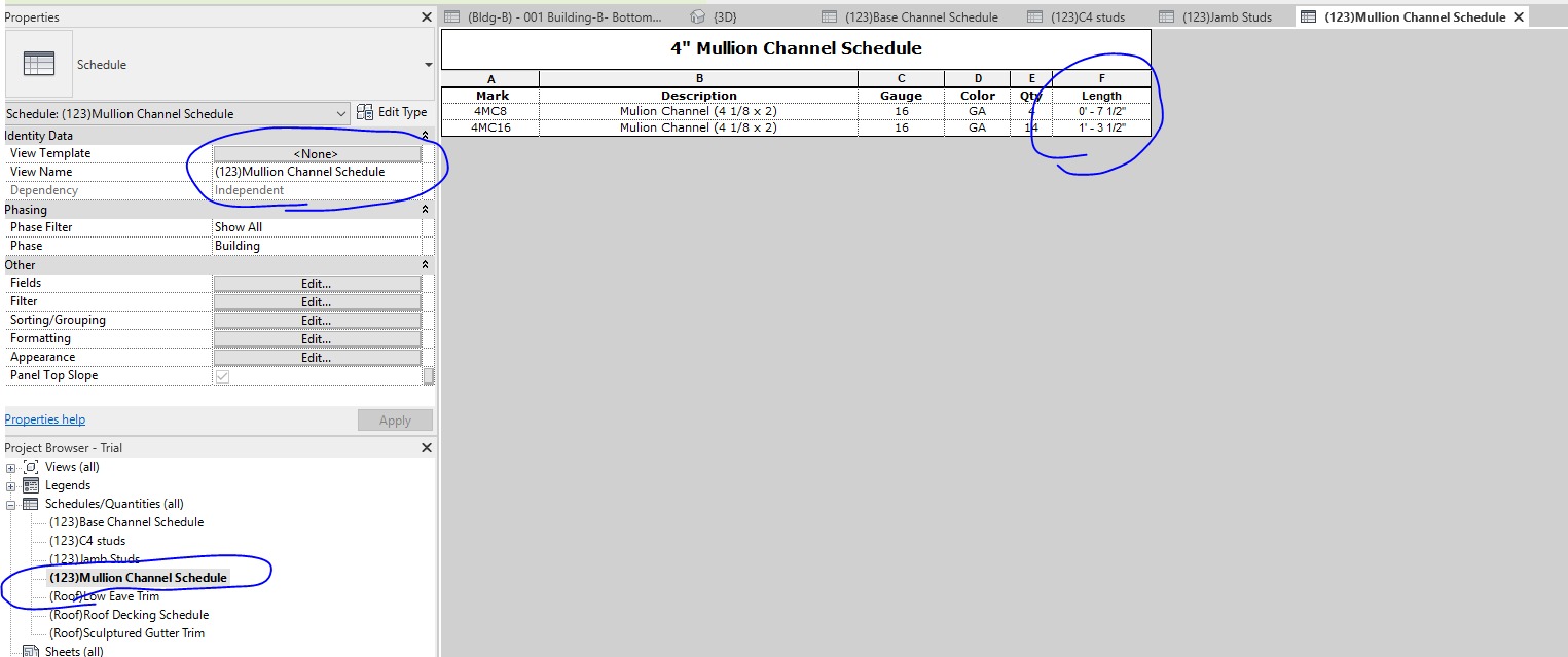

Please find the Revit Schedule Images, Dynamo Script, Excel Workbook Files we are using to export Revit Schedules to Export at Specific Rows.
We Need Output As Explained As first message, As of now we reached to level Shown in dynamo script. We exported all schedules with 123 text in schedule name to 123 sheet/tab in excel & with roof text to roof tab in excel workbook, but we are unable to export those schedules at exact rows & columns by adding new rows as required if needed. Please review.
