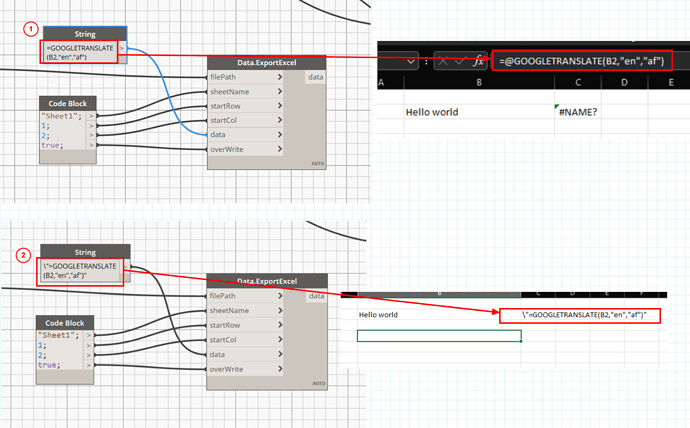

Hello everyone, I am currently struggling to export a formula to excel to automate the translation process. When I export the string to excel it changes the formula. I have tried to use escape characters and just ends up exporting the escape characters too. Any idea of what I can try to solve this?
GOOGLETRANSLATE() formula work only with Google Sheets
If I open it within Google Sheets the formula also changes, should rather export directly to google sheets?
this requires using the Google API
