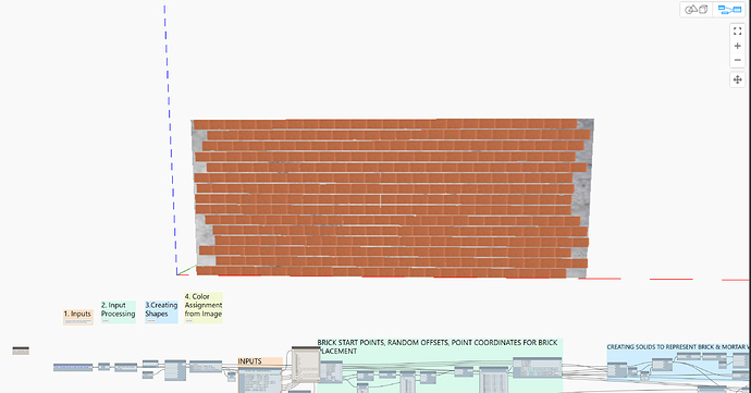

Hello, I want to export the background 3D preview images in bulk, but the only option I see at the moment is doing so manually. I have a script that runs in periodic mode and reads excel with hundreds of data to create the brick wall geometry. But now I want to export the 3D preview as image from dynamo. I read on one of the posts that it’s possible to use the import the export as image function in the menu as a node?
If so, how can I do that? Alternatively does anyone know a way to capture screenshot using the python node? Thanks a lot.

Maybe consider adding some coloring as well?
Hi Jacob, thanks for your suggestion! I looked into their source code and did find a related function. But I’m strugggling to make a zero-touch node for taking a screenshot in dynamo. If you know a way to do so please advise. Thanks a lot!
