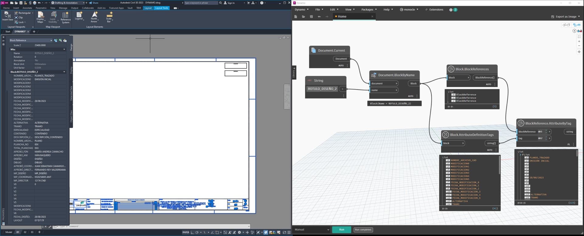

I have a block in the layout (for the sheets) and I need to extract from all the layouts (without selecting them) the entity handle of the block, the name of the block and the name of the layout where it is drawn. I have the following error in the code: AttributeError: ‘document’ objectc has no attribute ‘Document’, line 7.

Hola amigo @alejandro.hernandez3 buenas. here’s how to do the query you need, it’s simple just pay attention to levels.
