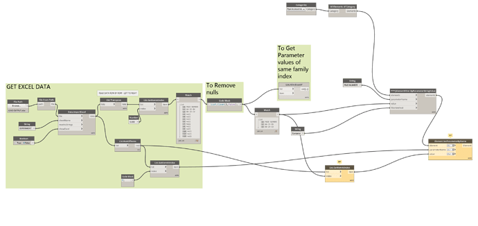

I was trying your files because I was experiencing a similar challenge myself. I am still new to Dynamo myself and am not a Revit user/engineer, so I might still get some of the terms wrong, but understanding the logic of Dynamo, I ended up with this version
by logic is should be right, we get the RestOfItems, and determine the ParameterName in SetParameterByName using a list
and the values should be the list of items at index under “P&ID Number”, which we have listed after removing nulls…
there is an error however, because GetItemAtIndex requires an Integer for index, and does not accept Strings
currently looking into the comment by JacobSmall, although Dictionary is a new node I tried in Dynamo and am still learning it

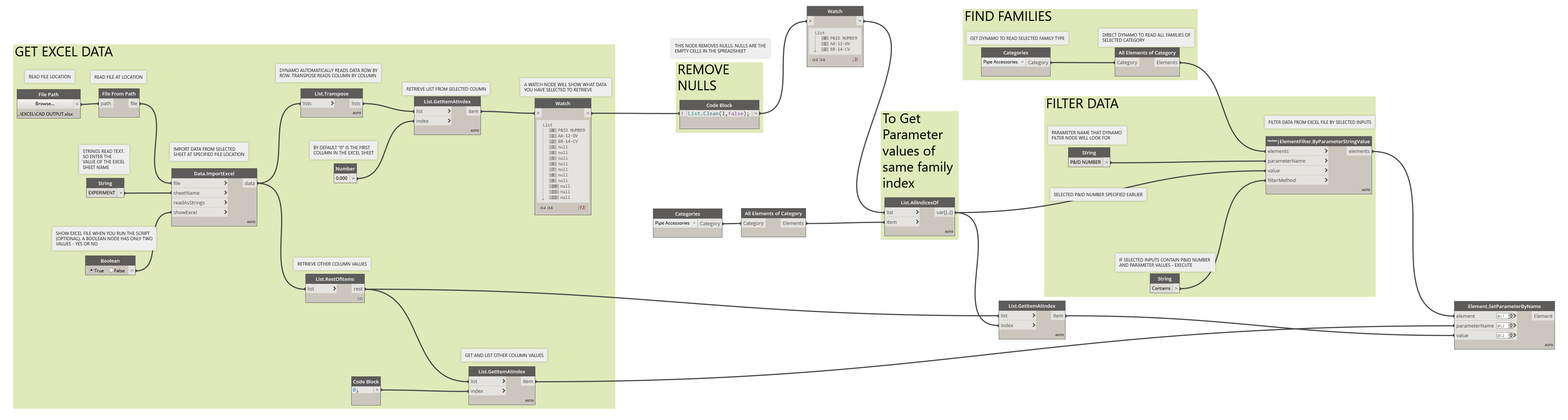

Tried something here. A bit messy and probably has some redundant/unnecessary nodes down there, but this is the flow I have gotten this morning.
After removing nulls, we have the 3 items, P&ID NUMBER plus the two entries under it, AA-12-GV and BB-14-CV. What I was trying to do is to get the INDEX NUMBER of both, which is 1 and 2 (because GetItemAtIndex requires an integer not a string)
I used FilterByBoolMask, connected the list, and made a condition that it does not equal (!=) P&ID NUMBER.
I tried getting the IndexOf to get their index number, but since P&ID NUMBER is gone, both AA and BB are now 0 and 1 respectively. I added a (+1) so they are now 1 and 2.
Plugging in this to the GetItemAtIndex, I see that both 0 and 1 lists have the corresponding AA and BB information
Only the AA values are getting plugged in however
