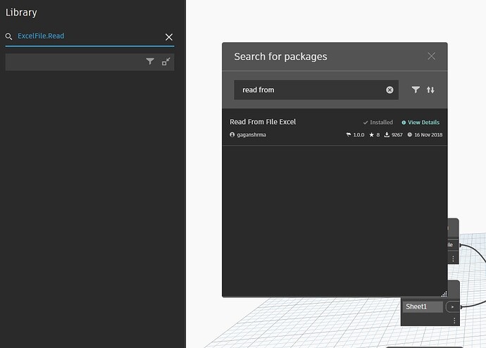

I am trying to import an excel file but I do not know why it is not importing. Also, I tried to download “ExcelFile.Read” node, but i cannot see it. Is that node not working anymore? I closed the file and opened it again. I can import .csv file but not .xlsx file.

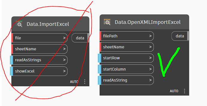

Try the OpenXML version of the excel nodes.

it seems there is no problem but maybe it is, i do not know. however, .csv file is working and also I cannot find the “Read From File Excel” node which I installed.
The node you want is on the right of this screenshot, not the left:
it is worked, thank you so much!
Likely confirms that there is a corrupted excel installation. You may want to run the online repair tool just to be safe.
