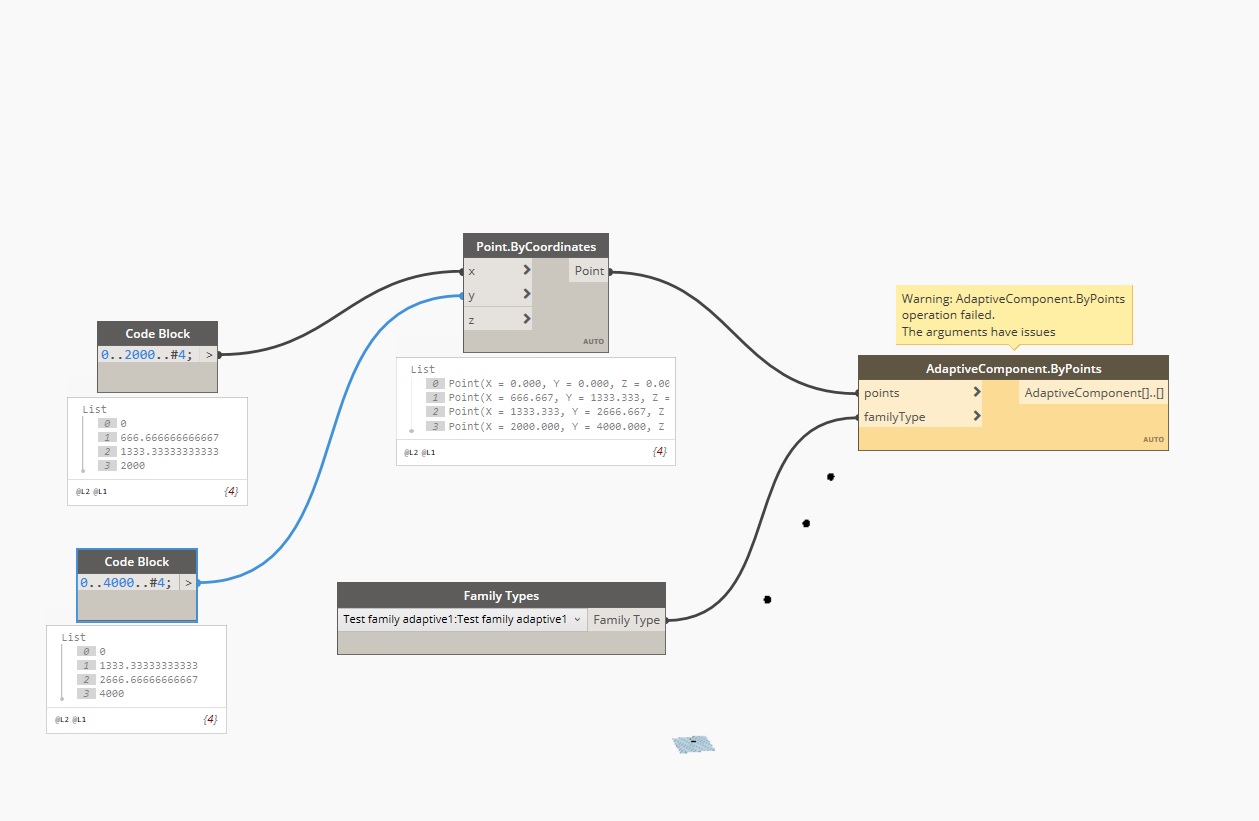

Hi dynamo experts, I’m trying to use Adaptive Component.bypoint node in my project, but unfortunately I can’t make it work. I have checked previous threads with similar topic, but I couldn’t find any solution. Could you please help me? thanks in advance :slight_smile:

Are you sure that your input are 4 different points?
Could you show your x,y,z coordinates? Where are you getting those points from?

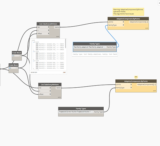

Looks good to me:
Hi and thanks @Kulkul for your answer. I tried exactly same script and I get this one below. I really don’t know what is going wrong :confused:

Hi and thanks @M.Perez for reply. Here is the coordinate for my adaptive family.
Hi @NaSha
Add List.Create node you should be fine then:
