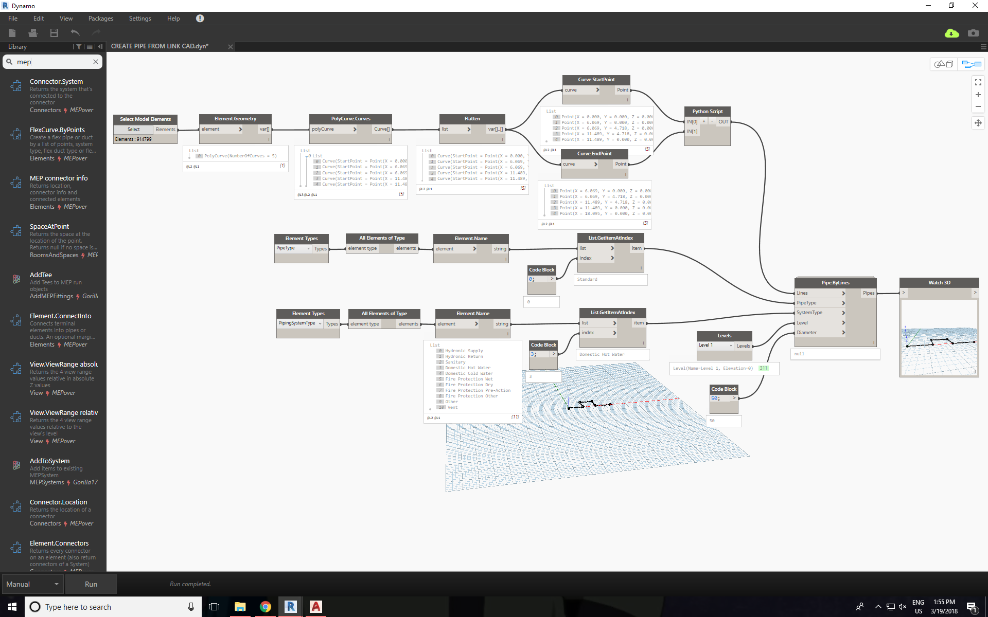

I wrote a code using dynamo from cad link but it didn’t work.
It appear point and line with blue color by cordinates but it isn’t drwaing soild pipe.
Can you help me?
Sincerely, thanks you very much.
DRAWING%20PIPE%20FROM%20LINK%20CAD%202

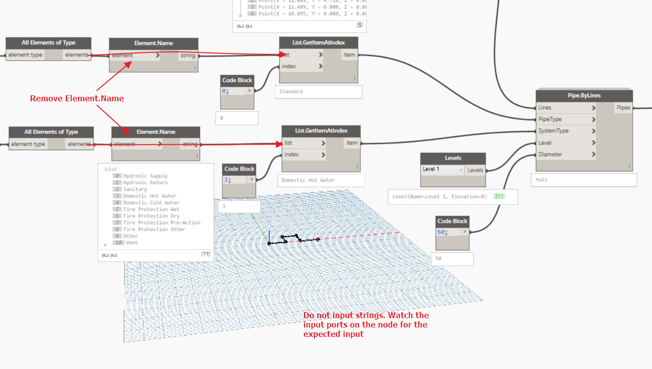

This same question has been posted a few times on the forum already and the answer is almost always the same: Check your input ports:
Thanks you for reply @T_Pover :slight_smile:
It didn’t appear a soild pipe, only points and line with blue color.
I understand about it, you can check for me.
