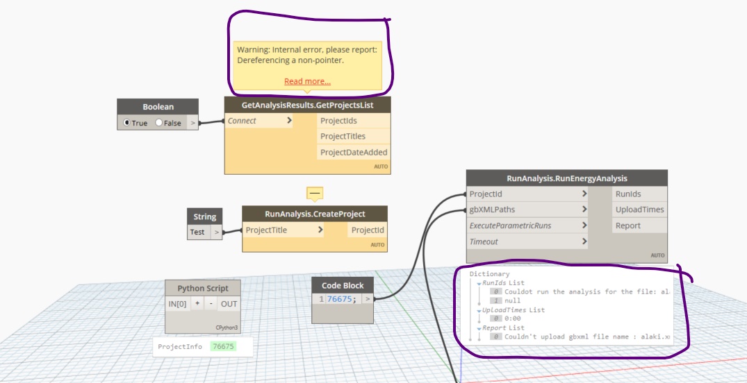

I am trying to run the energy analysis package in Dynamo. I was hoping to get a variable like energy use intensity back from Green Building Studio, and then use Optimo to optimize a solution.
but i am stuck within the use of “Energy Analysis for dynamo” package and i can not go further, here i have problem with the first node for getting “RunIds”. I have searched and watched whatever I could during this month, but it doesn’t work.
Has anyone else run in to this issue or have any advice? Thank you!!
Can I ask you how did you get the project Id, in my case this node also is not working
To get the ProjectInfo you can use this code. But I am not sure if this is the correct input for ProjectId or not. When I ran the code, it returned the exact same number.

Thank you very much, and can I ask how did you write the path for the files, I mean the gbXML paths??
I have the same problem in the analysis
Could not upload the gbXML file
hi razan
you may use File Path node for this,

Thank you Khuzaimah, but still uploading the file is failing in the Run Analysis node
Hello
you also tried with the Id
Sincerely
christian.stan
Unfortunately, still the RunAnalysis.RunEnergyAnalysis node is not working, I am not sure if it is related that I have a student license?!!!
I myself have an education version (never had any limitation, what would be the point of it, you must provide a school certificate to avoid misuse of the private sector)
you tried with the branch from the python node so in this case the x[1] for you here.
I don’t have this node (maybe on 2024)
