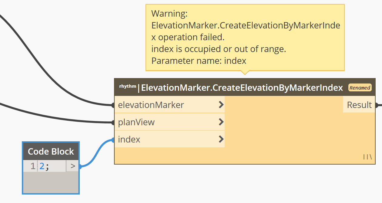

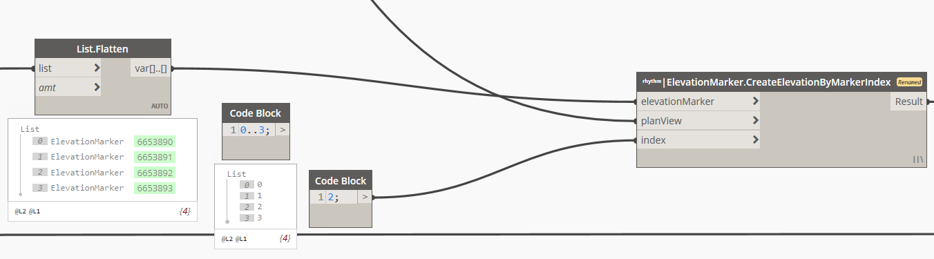

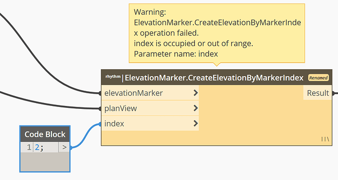

Elevation create by marker index - index out of range
this was working now all of a sudden stopped…it seems to work with index 0 but not when fed anything other than 0??
@john_pierson
The elevation marker family type you placed: does it in fact have more than one direction in it? Double check that. :slight_smile:
…son of a…thats exactly the issue…
I learned that one the hard way myself. :wink:
I suppose I could look at adding a node that counts how many indices are available in any given marker?
it was working previously but i purged to clean up my test project…i purged out the multi-elevation…looks like i need to orient the markers to faces.
