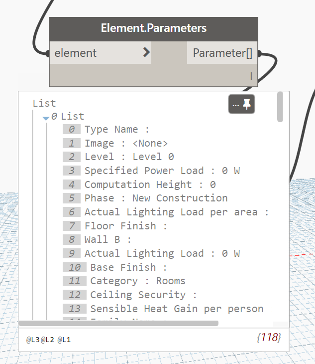

Hi, after some advice please. I have set up nodes to collect all parameters from rooms with a certain value and successfully writing all the parameters to excel. I have then set up nodes to read from the excel file and set those same rooms parameters. Changing a value in excel (a parameter I know I can change, eg name) has the desired result of changing the value in the model with no warnings. However, If I try this operation again it fails totally as it appears the Element.Parameters node has collected the parameters in a different order to when I was writing the excel file first time around. So it is trying to write the wrong values onto the wrong parameters and Revit no likey. Am I doing something wrong here? I have tried disconnecting the Excel.Write to file completely with the same results. I would have thought the data collected from the model would always be in the same sequence or is this not the case? Is there some way to control the order whilst linking the parameters values obtained elsewhere? Thank you. Room Schedule.dyn (18.7 KB)

This has been addressed here https://github.com/DynamoDS/DynamoRevit/pull/16934 Fix will be coming in the next release of Dynamo. For the mean time you can use this solution to sort all the parameters in same order.

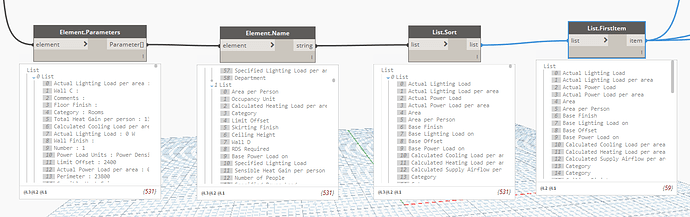

Hi All, I have sorted the parameters first (top image), which seems to prevent them from randomly reordering. However I am now stuck trying to map the values and parameters together (bottom image). I’ve looked at the Replication guides in the manual but not sure how this helps. Any ideas? Thanks. Room Schedule 2.dyn (19.5 KB)

Finally got there thank you. Though I still get an error in the set parameter box regarding container not a string - it still works fine! - have to disconnect the data to the write excel node before bringing data back from the excel - but yeah works ok. I seriously need to actually understand lists, levels and lacing rather than just play with all the buttons until it works! Once again thanks!

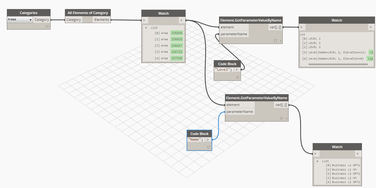

Please see this simple graph (running 0.8.0.950). I am getting inconsistent results for the level names. Notice how some report just the name and others report more information, including the element id of the level. If I make a change to a level, the list changes and the output will shuffle again. This doesn’t seem right. I tried it with rooms too, the
same result. Thanks.

That version of Dynamo is 4 years and 8 months old. Please confirm similar behavior in a current build (2.0.3).
