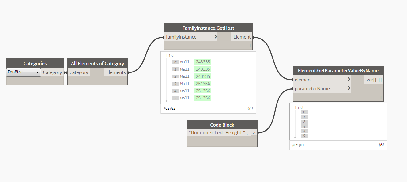

I use dynamo 1.3 on windows 7
I’m trying to get the height of my windows by Element.GetParameterValueByName
But I get a list WITHOUT VALUES.

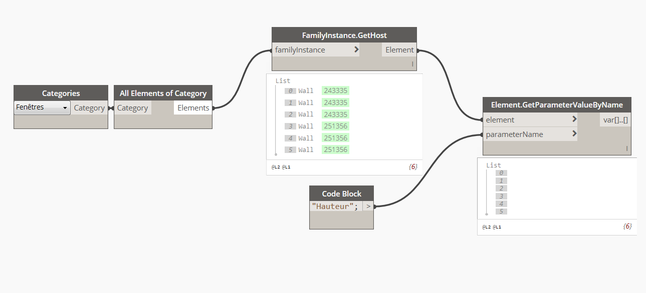

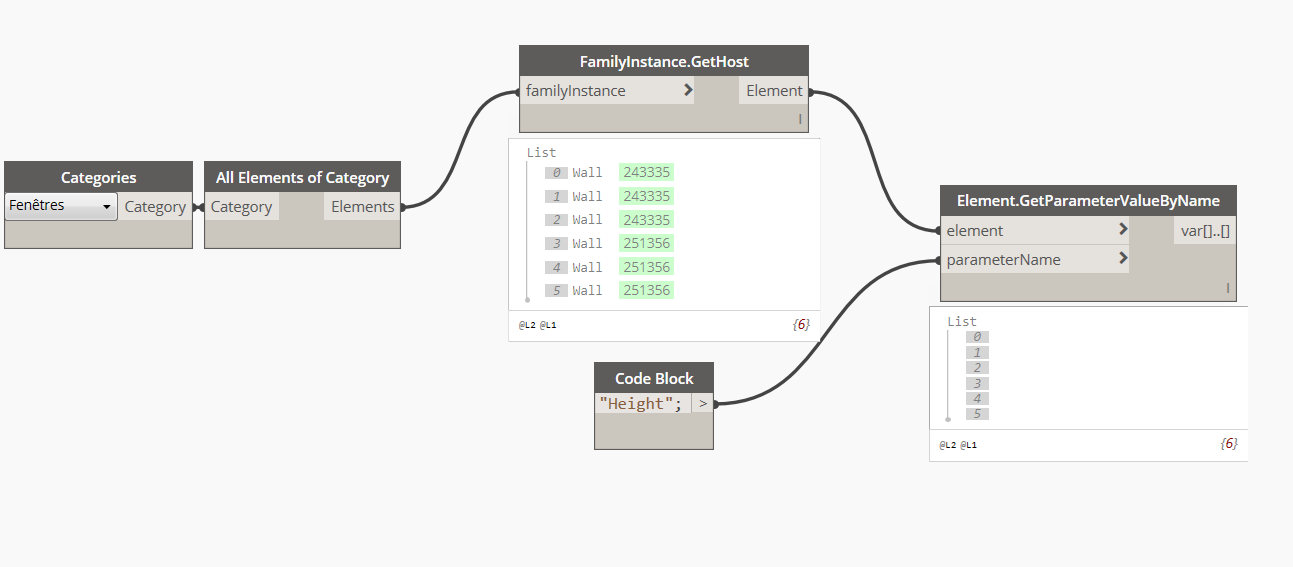

I tried many parameter names (normally the three of them are correct), I tried also the LunchBox,
I have the same problem with walls.
Do you know where is the problem?
Their is another function that I can use instead?
