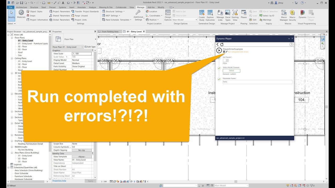

Woah, I didn’t realize that suppressed binding too.
I have a video covering using functions to suppress warnings, maybe that helps?
