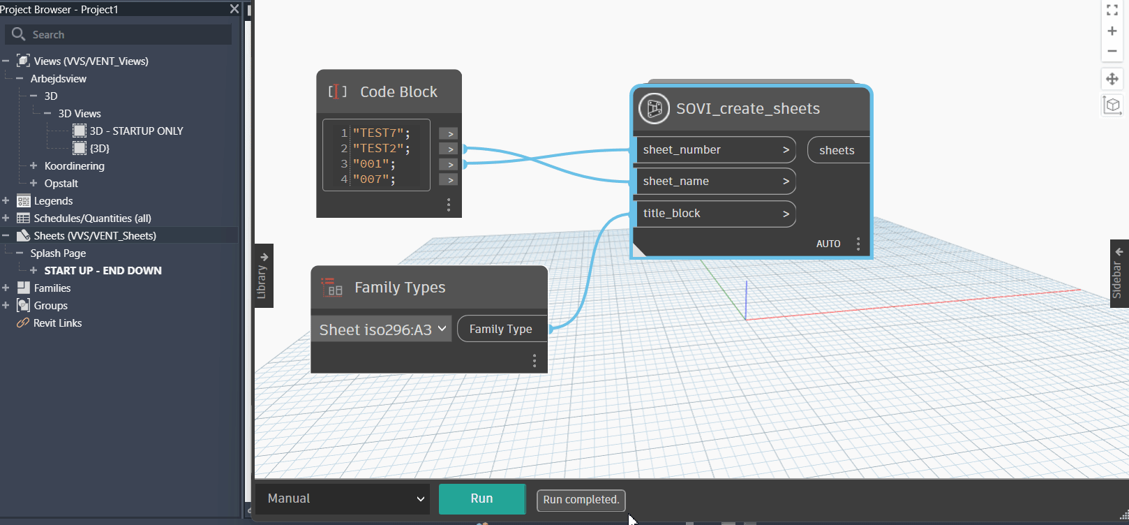

Hi, I was wondering if it is possible to create a new sheet in Revit via Dynamo every time I run a script. In my case, my new sheet overwrites my old one.

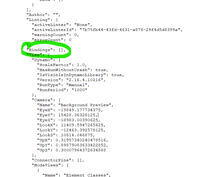

This is Element Binding. Read over the linked topic for a solution.
yeah element binding, try run from player if it ootb you use or try create you own, where we can disable element binding…

Clear the Element Binding as noted in the thread, and then use Dynamo Player.
Alternatively you can look into function passing which suppresses bindings, but also suppresses all warnings and is significantly slower.
I mean, as I can see it’s already turned off.

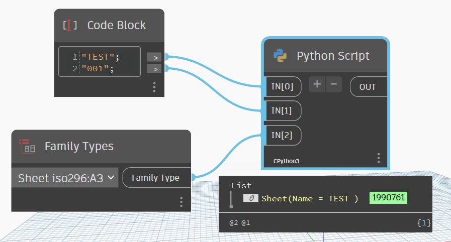

Hi you can try this one i have shared here, it dosnt have any element binding…
Since bindings are cleared, I think you can now move to Dynamo Player for the production use.
I used @sovitek 's python code and I do get a new sheet every time I change the name. But the problem is putting something on a new sheet. A new sheet gets all the views, but the old one becomes blank. I use Viewport.Create node from rhythm package for that.
