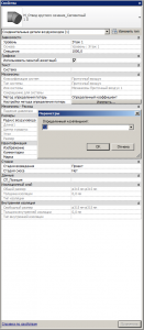

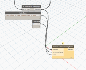

Hi Comununity,Actually the question: Can not change the setting in the family allotment. Dynamo complains that it is not a number and not text … To edit in Revit, an additional window pops up. How to deal?
Hi Alexey,
It would be better if you can post this in English, Which family are you using and what’s the parameter name you need to change.
Family: fitting duct
Parameter name: Loss method - Specific coefficient
Loss Method Settings, click Edit - I need to change
