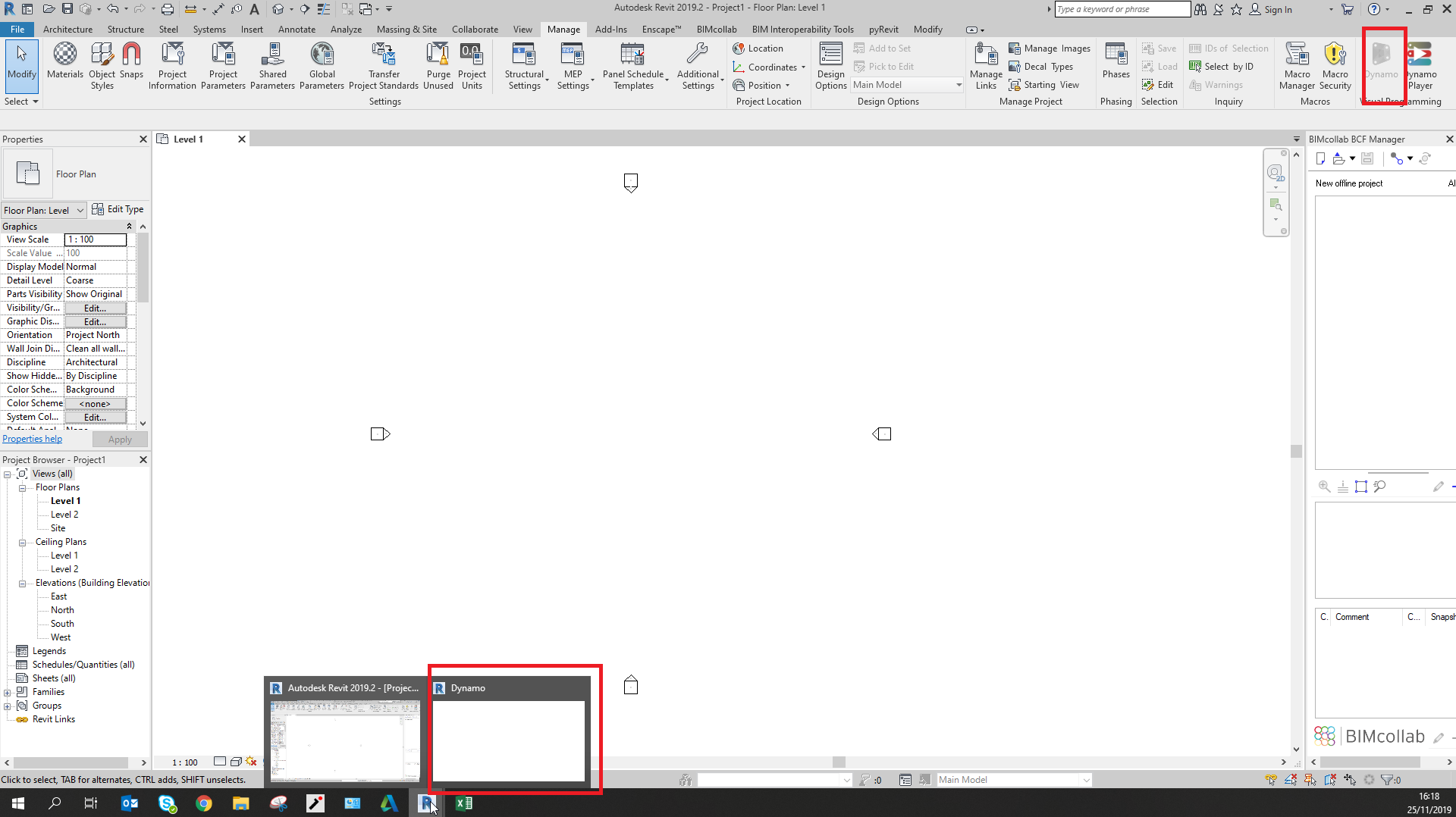

I downloaded the above version of Dynamo, but it doesnt work properly. It seems that the Dynamo window is open but I cannot pass there…see attachment.
Thank you!
try to restart your PC first, or re-install dynamo agian
thank you for your time.
I should maximize the window…I found the answer here - > Dynamo won't launch
