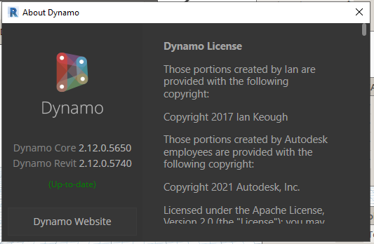

here is my About:

I am fairly certain performance improvements to search were in 2.13, not 2.12.
What is the most up to date version of dynamo I should be on? and it looks like there is a special installation procedure of some kind? Can I just run the exe? or is it more complicated than that? please advise.
Since the 2020 release the only way to update Dynamo for Revit is to update Revit, so don’t go looking down that route.
