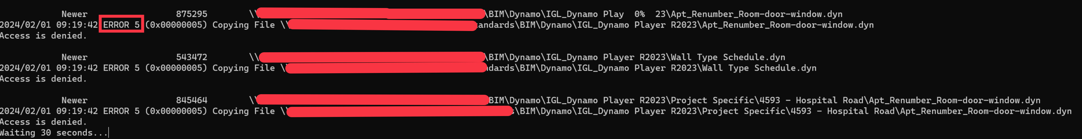

Hi, have a script at work that copies packages and scripts to computers at work when they start up. However I’ve suddenly started to get the error below. I’m wondering if its to do with maybe how an updated dynamo saves files. It could be related to my new computer but IT says its the same as my old one. I only vaguely to probably not know what I’m talking about

That error usually means you aren’t seeing the file, or see it but don’t have read access. My gut says your network drives are mapped differently on the new CPU, or a VPN issue, but only your IT team would know for sure… if you manually navigate to it does the file read/open?

If I copy an older dynamo file with a new name. Itll copy across. A new saved dynamo file wont. I’m going through the properties of the file and all the permissions are the same
If I modify the old copied file in dynamo and save. It looses ability to copy across. Hmmm
sorry for spamming, actually looks like the owners different under details

Robocopy doesn’t like it if the file is in use, I’ve had this when using the ‘open() and close()’ commands in python for text file editing. Check that the file and destination file aren’t in use? Network virus scan locking the file?
Could also be your network path formatting, I had similar issue a while back and it came down to which route was being taken via the network. We had a P:\Folder1\Folder2\File1.txt that would only copy if i used a full \server\domain\Folder1\Folder2\File1.txt path. I’ve taken to using the ‘os’ module in python and feeding most things through ‘os.path.normpath(file_path)’ just to be sure

If this is a network location, try using the UNC pathing vs lettered drives. I’ve begun doing this as we have users with different drive mappings in place.

Scrap everything. I’m now realizing I was probably remoting into a desktop computer when I made changes to the 3 difficult files copied to and stuck on peoples machines. So I’m going to find a way to clear out the files on everyone’s computers and be sure to make changes on my administrative computer that has whatever rights when copying to a computer after I save.
