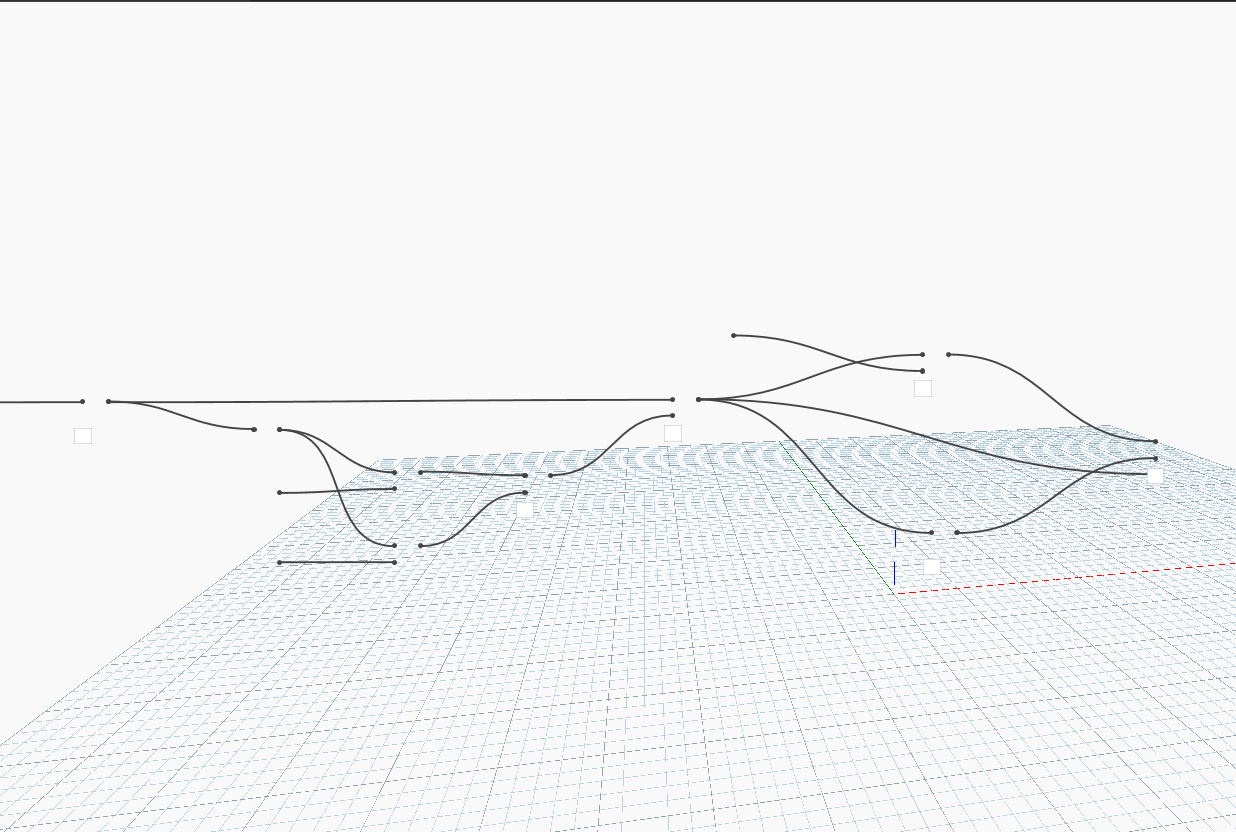

Dynamo problem: nodes are not visible, dynamo is very slow and functions are frozen
a colleague has a problem with dynamo.
He has Revit 2017 and Dynamo 1.3.
  1. the nodes of Dynamo scripts are not visible (OOTB-nodes)
  2. interaction with Dynamo is very slow, for example the start from Revit
  3. if a script is open, you can’t select a function or anything else

So I recently encountered the same problem in 2020 while using Revit 2019. Some of the signs I witnessed were:
  1. Dynamo was launching really slowly.
  2. File opening in dynamo got slow as well even on manual mode.
  3. Upon the .dyn file opening up finally, all the dynamo nodes (including the OOTD nodes) had disappeared and only node connections were visible.
