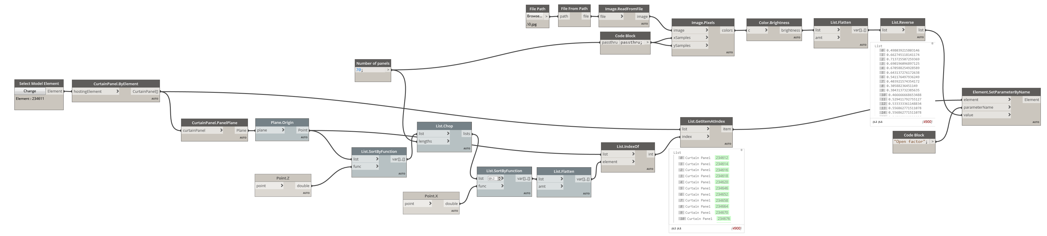

I’ve been trying to map an image file using the Image.Pixels node fed into a brightness range (then applied to a curtain panel aperture). I’ve applied List functions to the panels to arrange them by Z then X values (as sub-lists/rows of panels).
I seem to be getting fairly inconsistent results when I change sample sizes, and none seem to fully map the image to the panels. See below:
I’ll upload the script shortly to see if anyone can identify an issue coming from that. The panel and pixel counts are correlated in each case so I don’t think it’s a list logic issue… any help is appreciated.
Also if there are any known bugs or limitations with the Image.Pixel node I’d be appreciative if anyone can enlighten me on them, I’m beginning to suspect maybe the node isn’t working as intended, or I’m not understanding how to properly use it.
Edit: see below/attached script for context. I’m basically applying it to a curtain wall by fixed count using the attached panel family.
Image map to curtain wall panels.dyn (36.9 KB)
Panel family.rfa (312 KB)

I think this is fixed in 2.1 - what version are you using?
@Michael_Kirschner2 thanks! Yes I was reading through that post prior to posting this also - I thought that derived from an issue relating to the start point of sampling vs. the error I’m running into above where the samples are inconsistent regardless of the border row/column’s sampling point. Having re-read the body it appears to imply 2.1.X addresses many issues however - seems to indicate this was a known issue in 2.0.X? If so that’s a good enough answer to my query - if you’re able to confirm I’ll treat this as answered.
I’m currently running on 2.0.3 as I have to write in a version my users can rely on for stability unfortunately - I would have remained on the currently endorsed 2.0.2 but ran into conflicts between Clockwork 2.X and archilab, of which 2.0.3 was the only fix. I understand 2.1.0 is still in testing phases - but will make the jump asap. Does it run parallel 2.0.X or does it replace the build? If parallel I can download as a test I guess…

2.1.0 is available in Revit 2020. :slight_smile:
OK… still trying to get my hands on a live version in office due to the 4 versions apart rule on AEC suites. Is the 2.1.0 build stable for use in 2019? Haven’t got any direct confirmation it’s the version that is at fault but most answers seem to be leaning towards it at least.
