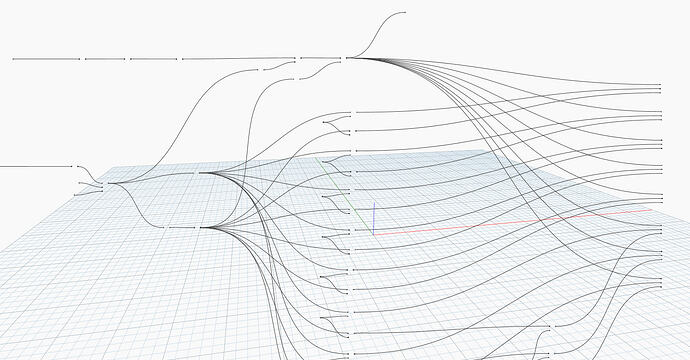

After this there are no notifications in Dynamo, but Dynamo sees existing scripts like this
And I cant seem to add any nodes, Dynamo just freezes.
