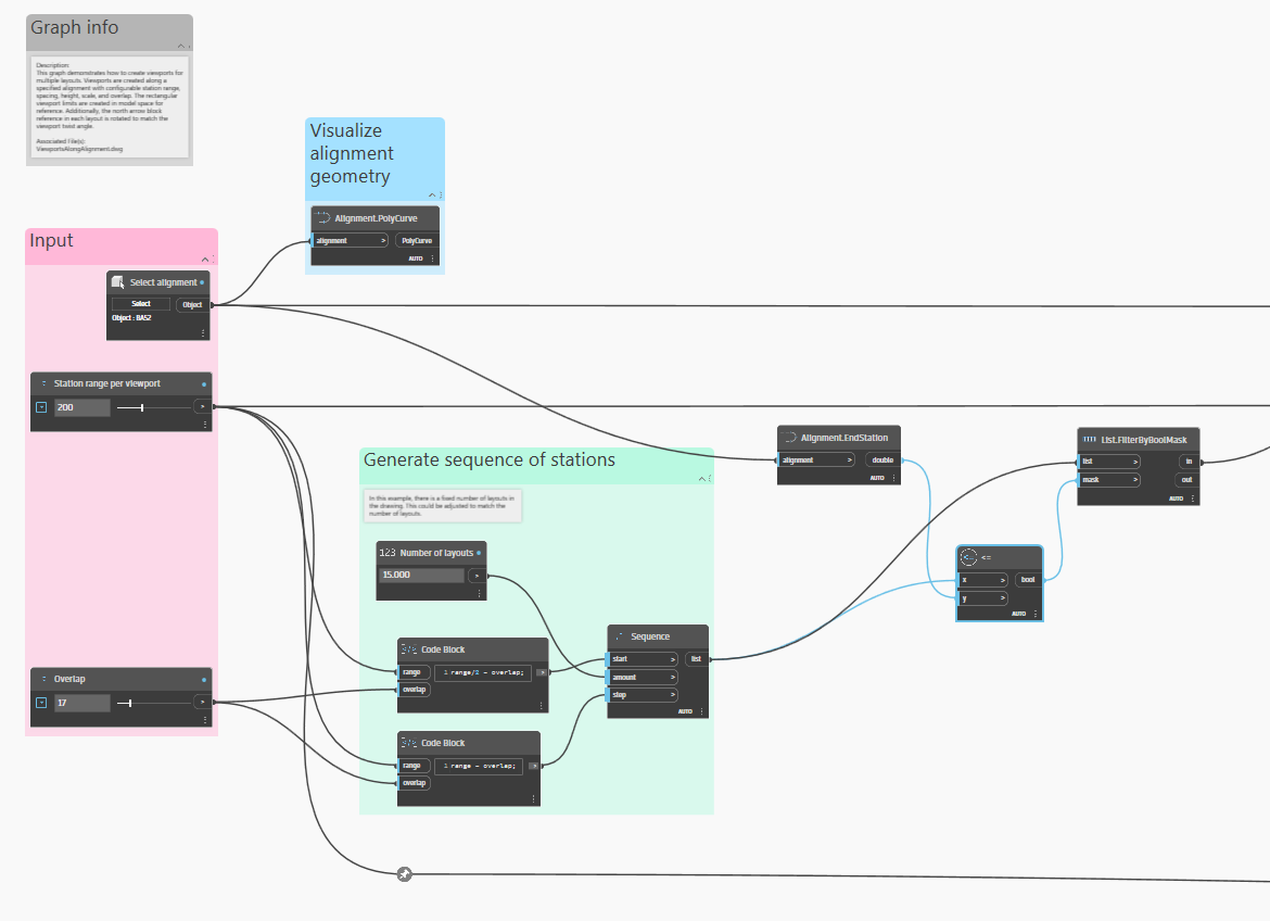

In the Sample graph for 2025.1 I would like to add these nodes for the ViewportsAlongAlignment.
Then user will not get error message if the amount of viewport covers stations greater than the Alignment End station
That’s a great suggestion, Patrick! We can do that :+1:
