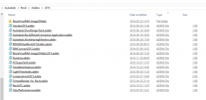

I do not have Kiwi installed. Here is my Addins folder for 2015:
And here’s my Dynamo.addin content, all in one line: "<?xml version=“1.0” encoding=“utf-8” standalone=“no”?>

I installed 0.7.5 today, and problem persists. Like my friends above, I have one laptop working perfectly, and one desktop wont start Dynamo.

Hello Håvard Vasshaug,
Just like Kiwi, I think there are some other addin also causing Dynamo to launch.
Do you have same Addin on you Laptop as well. Are there any difference in Addin on Laptop and Desktop.

havard, i removed all my addins… since then no troubles with dynamo
cheers
FYI - for me both the Unifi and Maxwell addins seem to prevent Dynamo from being launched from Revit 2015. If I take those out of the folder, or just rename them, Dynamo will launch as expected.

Thanks Peter. So, you now swear to no other addin than Dynamo? Nice:)
I made it work now but removing one at the time until Autodesk.FlowDesign.Revit.addin. As this method has worked for others with other addins, I’m guessing it’s not Flow Design, but a general attribute to a certain type of addins. Flow Design has a separate tab in Revit - could that be it?
Anyway, works now on my end. Thanks for the help guys.
