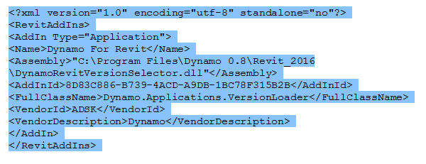

Dear Kulkul,
this is the content of the file (could not find an script viewer to display it, which one you used will try to use next time visual studio):
<!–?xml version=“1.0” encoding=“utf-8” standalone=“no”?–>
Best
Iker
Problem solve, I had to uninstall also revit and install all gain including Dynamo 0.9.1
