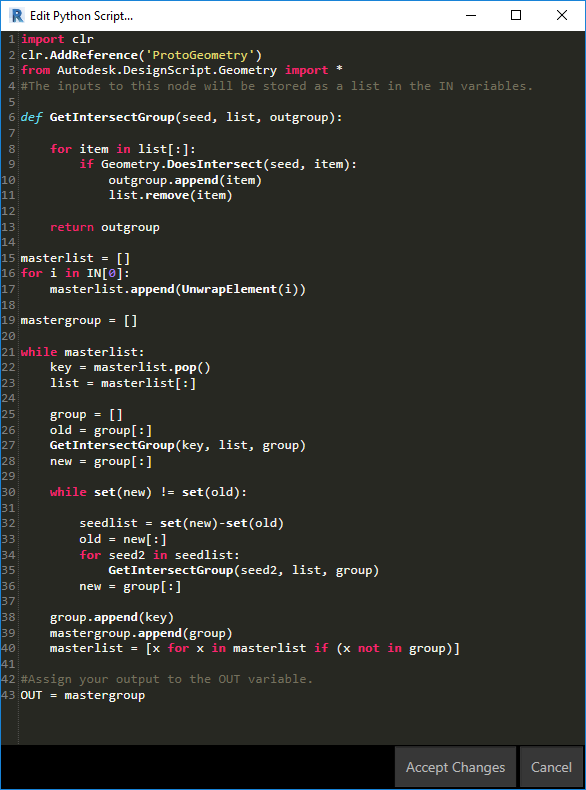

Hi, @alan.zhao
Thank you for sharing your video.
I was wondering if you can share the python script where the elements are grouped together.
I am doing something similar, but i am unable to group the elements that are intersecting.
Hi Blou,
Good luck on the rest of your work, regards.
