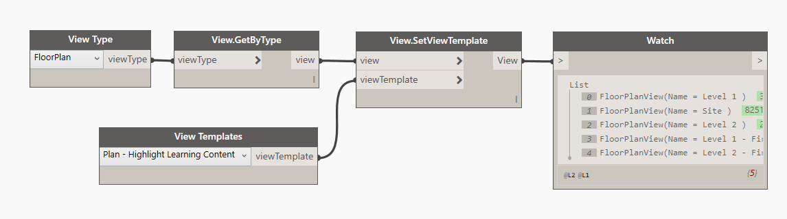

This is how I do it… Admittedly not in data shapes but maybe you can adapt… Perhaps an ‘active’ input is required?
Hope that’s helpful,
Mark

Alternatively, rather than use your IF, try using the same code I am (from Clockwork)…
I have done something very similar in the past, but how I have dealt with it is to create / duplicate the views FIRST, then apply the template to it AFTER it has been created with a simple Element.SetParameterByName node. This allows you to “skip” the template if one is not selected. I know in this case I am “hard” selecting it, but it would be just as easy through the Data-Shapes.
