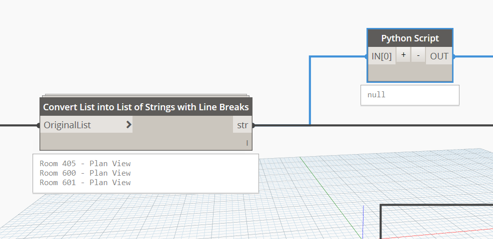

I am trying to get the attached script to duplicate multiple views multiple times in one go. It will duplicate a single view as many times as you would like but as soon as i select more that one view it will not work.
I believe the problem is this area is where i convert the list into a list of strings going in to the python script here:
The python script does not show null when only choosing 1 view to duplicate having no clue with python unsure if the issue is within the code.

The problem is that your Python Script cannot manage the input you are giving it. You are passing a string within three lines, not a list of three strings, thus the script is not founding any view which name is :
Room 405 - Plan View
Room 600 - Plan View
Room 601 - Plan View
returning the default value of foundView in the script, aka null.
Try replacing the script by this one, it will be able to manage lists of strings :slight_smile:

Also remember to change the input so it becomes a list :
[0] Room 405 - Plan View
[1] Room 600 - Plan View
[2] Room 601 - Plan View
This technique should work to split the string : ( "\n" is the way to indicate a line break) , but i think the best way is to definitely not use the Convert List into List of Strings with Line Breaks custom node …
