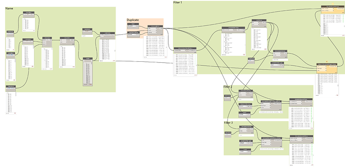

I’ve made a script that duplicates a schedule and puts the right filters on the new schedules. But after ‘‘bnr100’’ the script does not put the right filter on its schedule.
right schedule
right filters
wrong filters

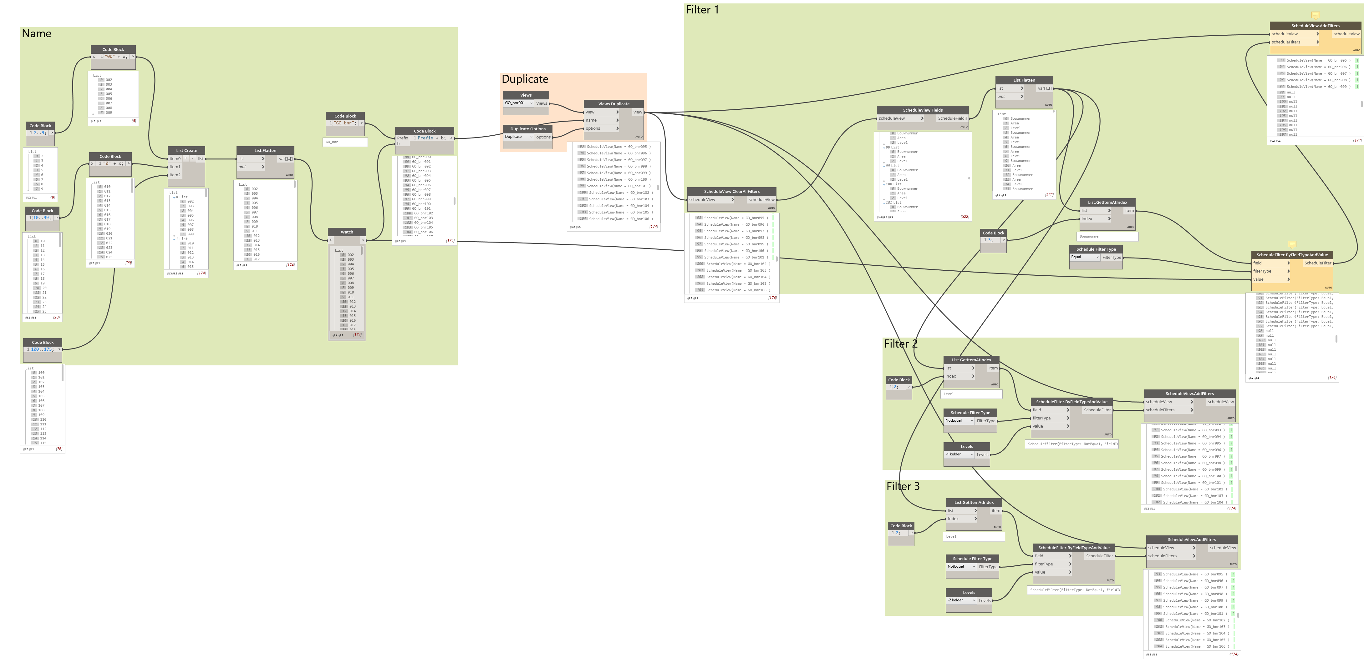

It has something to do with the numbers 100 to 175. value 001 to 099 goes fine. But after 099 you get the Null. I don’t know how to fix it.
Can you show scroll down in the other node previews so we can see what you are feeding this node at index 100?
What does this node show at 100

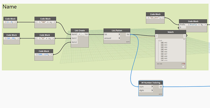

I think I got a quickfix for you. Add a number to string node:

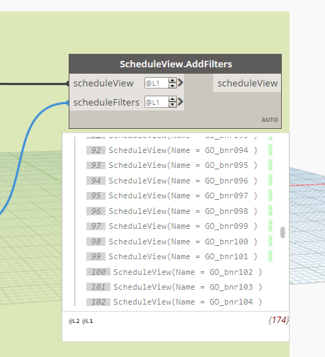

And make the scheduleview add filter to level 1 for both inputs.
The results will go further than 099 now:
Yes! It worked, thanks!
