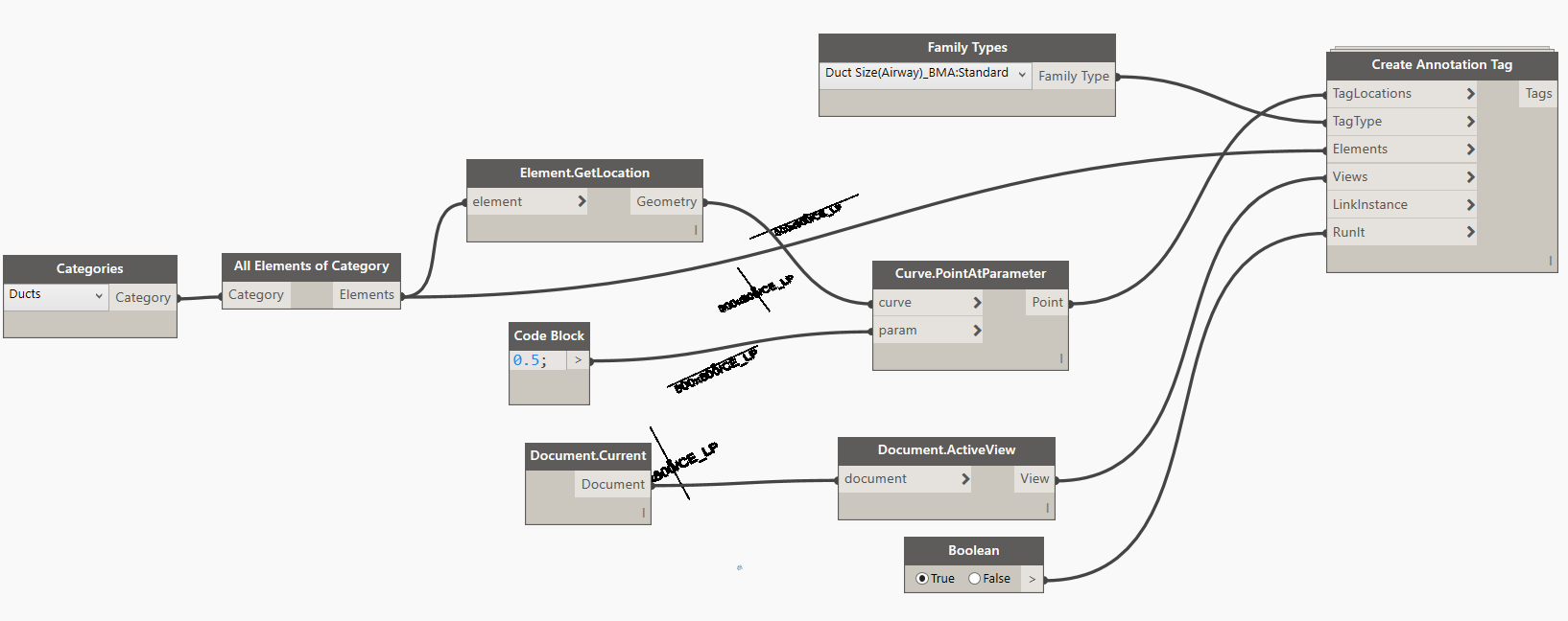

Duct Tagging Placement
https://drive.google.com/open?id=1oVEyoSESvRJocnB5hmAP7hk_ftQCTWHn
@Harywijaya.2 It’s working as expected. You just have to get the duct curves and use Curve.PointAtParameter for the location. I don’t understand why are you using all those custom nodes which can be done easily by very few nodes. Use the workflow as shown below:
Wait Sir,
I will try after finish daily task
will touched as soon as possible i can
thank you so much for before ^^
Hy @Kulkul
i am tried with your workflow
but it feel strange.
  1. why when you running, family duct length automatically tagging because in your workflow only there family of duct size
    2… why your tagging automatically split in upper and lower, i am exactly using your workflow but still keep in middle
Hi Kulkul
I have tried your suggest script, it’s running without any error but not getting tag on ductwork,
really appreciated your help
Jay
