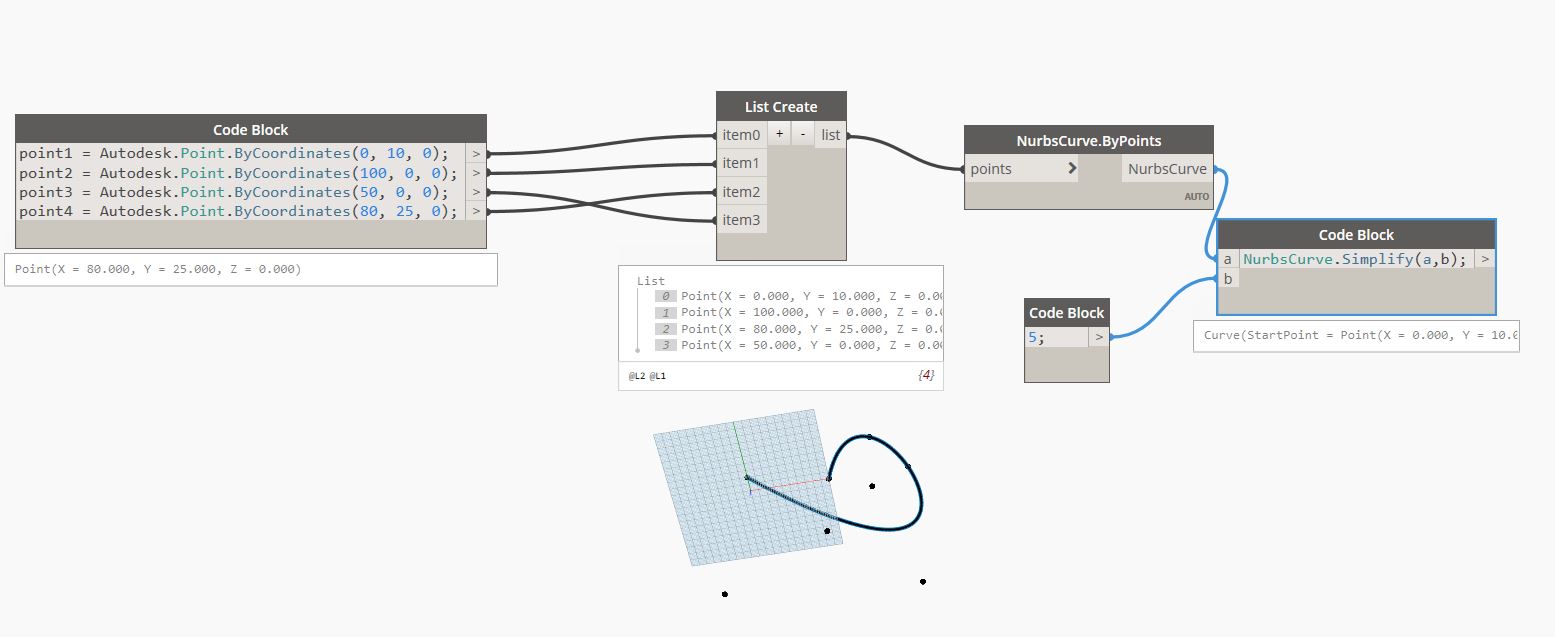

Hello, I am trying to create an arc that passes by three reference points in order to use it in an adaptive family.
I know that with dynamo there is the possibility to draw a curve by reference points but actually it generates a spline while I need an arc that behaves exactly like that curve, keeping the reference points attached to the arc in order to manipulate it.
Is there any way to do it maybe using also some piece of a python code?
I will also attach a basic exaple in order to make myself clear.
Basically I need to find a way to model that curve in order to be an arc.
Thank you for your suggestion, but unfortunately this node doesn’t accept as input reference points. My goal is to connect the reference points by an arc in order to use those reference points in a next phase to change the geometry of the arc.
But if this is all driven by Dynamo it doesn’t really matter which geometry you’re controlling. You can go back and forth like I mentioned by converting the geometry. As long as your adaptive points are in the right location everything should be good.
