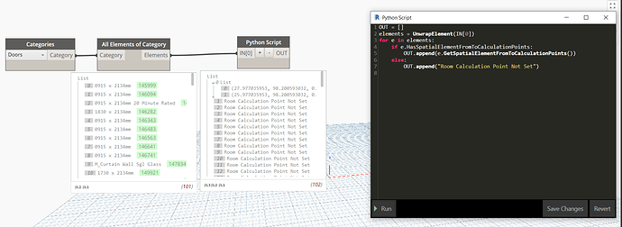

Hi @Paul
There is nothing wrong in the Method. It’s Just your families doesn’t have Room Calculation Point not set:
You could also use this few lines of python to know if your families Room Calculation Point is set or not.
Good Luck!
Thank you, it worked.
