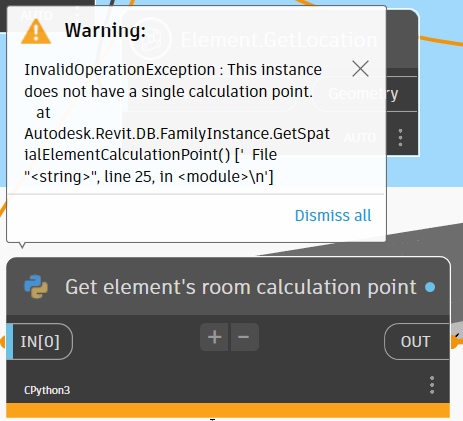

Instance does not have a single calculation point
I’m not sure if there is something going on with the families or with the python script. This script and python node as worked in the past. I’m not sure if there is a way to find the family instance that could be containing these multiple calculation points.
I’m also realizing now, that this might meant he family instance has no calculation point. The warning is kind of vague but I think the no calculation point interpretation makes more sense.

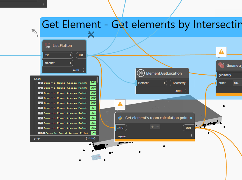

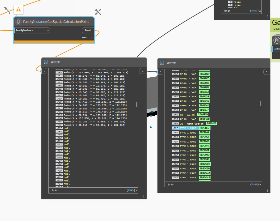

Was able to use an orchid to find families that return null.

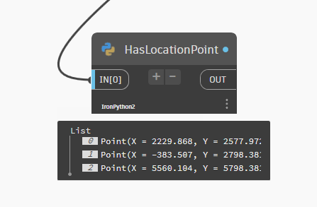

Issue is you get XYZ Values you have to feed points …

Thanks for the response but no. There were simply two new families that didn’t have the room calculation point turned on. I was able to select them using the watch node, open the file and update it.

finaly i am able to filter these elements:
elements = FilteredElementCollector(doc).OfCategory(BuiltInCategory.OST_GenericModel).WhereElementIsNotElementType().ToElements()
calpoints = [i.HasSpatialElementCalculationPoint for i in elements]
OUT = calpoints
