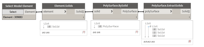

Is there node to divide one incoherent solid to many coherent solids? (Like attached snapshot) Or some reference resource can help me deal with this problem.

@Vo_Minh_Doan I suppose this should do the needful…

Hi Vikram,
I tried your way but with my floor geometry, revit inform a strong error and go recovery.

@Vo_Minh_Doan Works for me.
Your Revit file is ver 2014, that could be an issue.
Hi Vikram
I tried with later version of Revit and it worked also.
