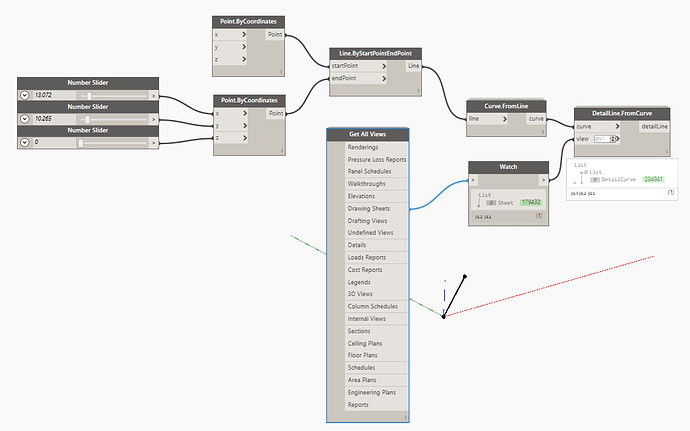

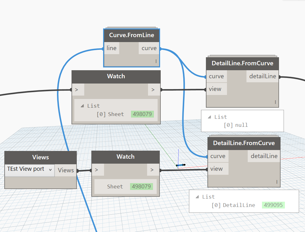

I am trying to draw a curve on a Sheet that I just created but DetailLine.FromCurv does not seem to like the view coming out of Sheet.ByNameNumberTitleBlockAndView. Once the view has been created I can feed it with Views and it works fine. See picture. Does anyone know why the Views node does not produce a list (I think this is the problem at least)?
You can set this by left clicking the “>” symbol on the node and checking the “Use Levels” checkbox. This will give you access to the selection box with the “@L1” text, use the up and down buttons to choose which Level of the list you want to use.
