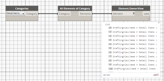

Hi @Noman_Khatri,
You should be able to get the owner view of the detail items. I think clockwork have a node called something with owner view.
@MartinSpence, @Noman_Khatri.
Like this: image
If this was the solution, please mark Martin’s post as the solution and not this one. It was just to show what Martin mentioned. :slight_smile:
Thank you Very Much Martin & CVestesen :slightly_smiling_face:
