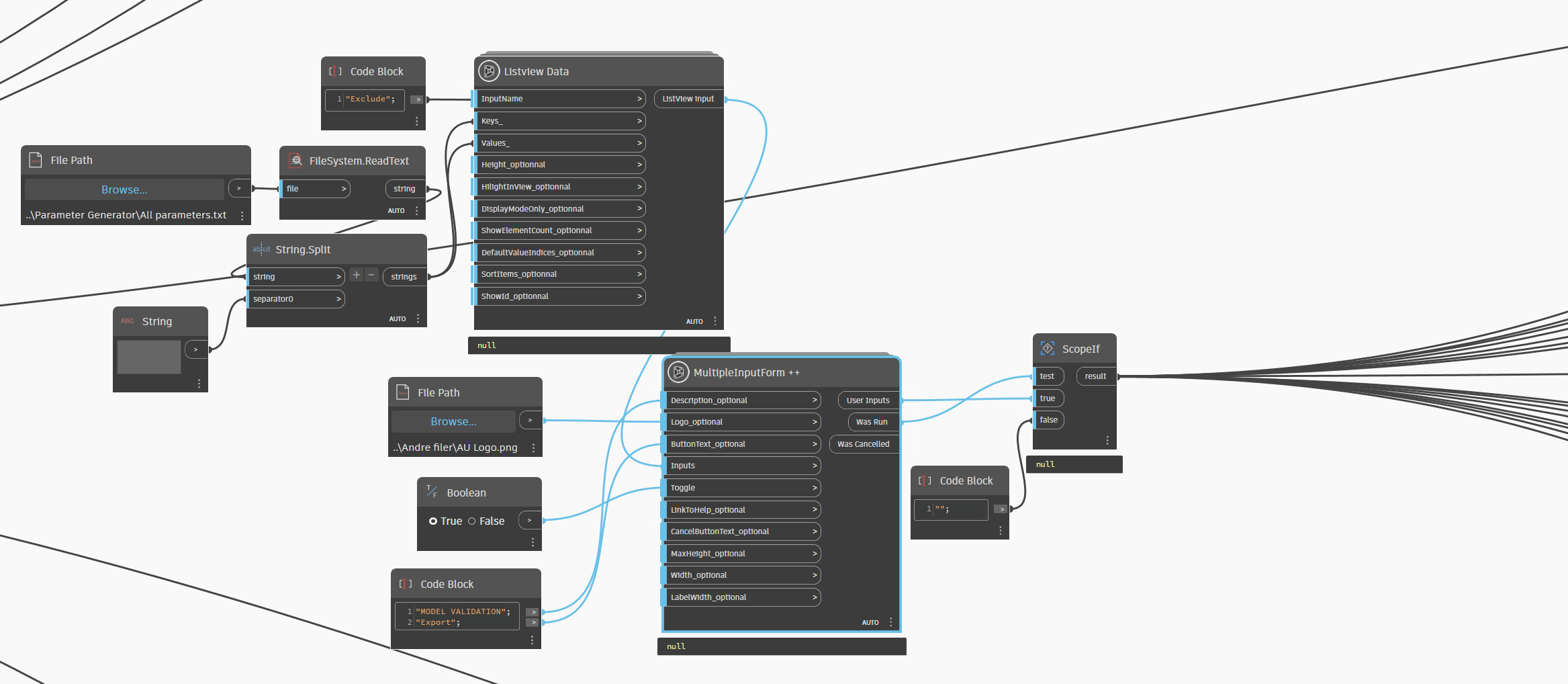

It does not work… I think… When I try to use my own setup and add the “ScopeIf+”, then I dont even get the interface showing up and the script is just “null” everywhere
That’s weird. The position of the scope node shouldn’t have anything to do with the Data-Shapes executing and showing the initial popup form. I have had issues with that ScopeIf node. Try using the ScopeIf+ node from clockwork. If that doesn’t work then maybe attach your script for us to test to make sure it’s not something else. BTW, if you input text for the cancelbuttontext option, you will get a true cancel button.

You can’t have a circular reference with the ScopeIf node. The true and false input branches won’t run until test has been checked and test is coming from the true input branch. ScopeIf is also going to control the upstream nodes, not the downstream nodes like you’re after.
Again, you need to check whether each previous UI node has been run or canceled in order to tell the next node to execute or not.

So this is the setup now, which wont run or show the interface. My problem is that if I remove the “ScopeIf+” node, the script will run no matter if I “Export” or close the interface showing up when I run it. In the interface I will have to select some parameters, which are then sent through and later REMOVED from another list of parameters. I hope it makes sense because the script is quite big and with a lot of local files connected, so I dont think I can send it :smiley:

The ScopeIf node isn’t really meant for the graph workspace, it’s intended for custom nodes. It’s likely going to cause you more trouble than is worth. Right now you’re trying to tackle two separate issues with one fix and that’s complicating things.
  1. You need consecutive UI nodes to execute based on the run/cancellation of previous UI nodes.
  2. You need downstream nodes to not give warnings when cancelled.
The first issue is solved by determining when a UI node has been cancelled, run, or closed and whether that should continue execution or not. Something like the following conditional should work:
wasCancelled ? false :
	wasRun ? true :
		false;
If the node was cancelled then don’t continue. If the node was run normally then continue. Else the node was closed and shouldn’t continue. The output of this node should then be connected to the run input of the next UI node.
The second issue just requires you do handle each node individually, based on what inputs it gets during a cancelled run. Most likely you’ll have a bunch of empty lists and null values. You need to determine whether you want to handle all those exceptions just so that a cancelled run doesn’t return any warnings.
