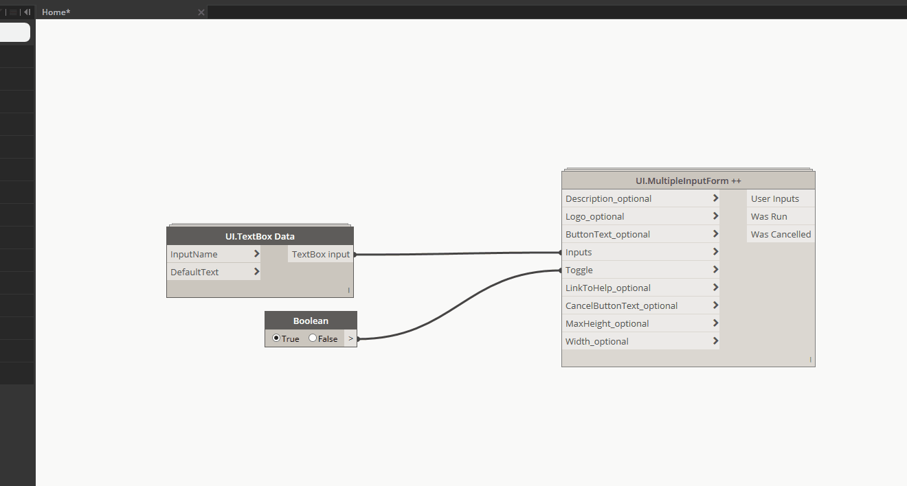

There’s a little extra thing to do on existing nodes after you update the package.
you need to right click on the new inputs and activate the default values :
This goes for UI.MultipleInputForm++ and all the “UI.xxx Data” nodes. You’ll know that all default values have been acivated when the title bar of the nodes become black instead of light grey.
