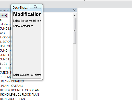

@Mostafa_El_Ayoubi when i run this it comes up blank without options to select anything?
Can you help?
Hi @jason.carpenter ,
I don’t have the same issue on my side. Can you please give me more infos about your setup? revit versions, windows version etc.
revit 2017.2
windows 7 professional
dynamo 1.2.1
the .2 version as posted here works great!
awesome :slight_smile: maybe windows 7 is why it didn’t work propperly… but this is just a rough guess I need to investigate more.
