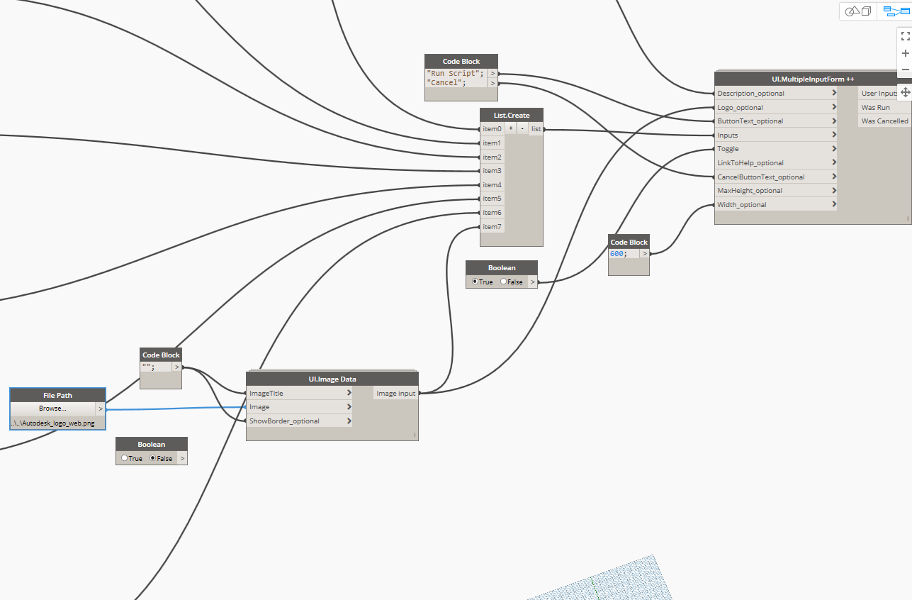

Hi All, quick question how do i get/put logo before description? same as shown below…Thanks in advance
wire an image file into the “Logo_optional” input.
Thanks @Jacob…I tried that but still not showing…hhhmn
Capture
That’s a file. You have to read the contents of the image before you can use it for anything. I think Image.ReadFromFile is the node name.

I’ve done the above steps, but my logo is coming in stretched to fill the whole UI Box. How can I force data-shapes to not scale my logo?
Hello to all,
I did follow instruction from the link:
But my sample logo does not display (please see image below). Any suggestions?
Connect from file path node in order to show logo.
Thank you very much Deniz.
If someone looking at this topic in the future, File Path block need to go directly to “Logo_optional” (“UI.Image Data” block is not necessary).
