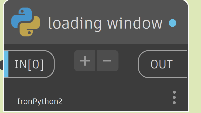

Which one should I install, and use?
The one that worked for me without ingeratting the scripts from 2024 to 2025,
for Revit 2025 you can use the following :
Data shapes 2024.2.114
DynamoIronPython2.7 3.2.0
